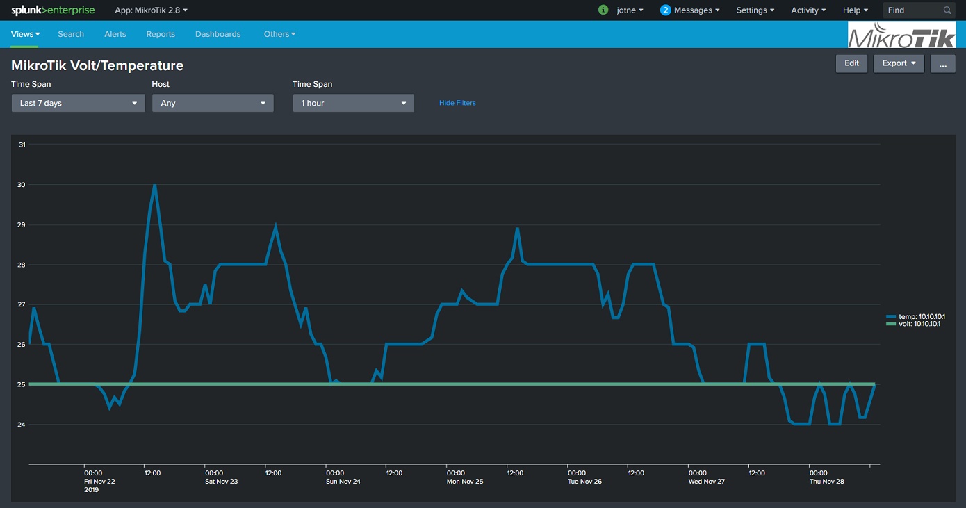

I have a solution that covers a lot of what has been requested, and more.
To use this you need to install and configure the basic scripts, see RouterOS scripts. Then install check-health and add a scheduler.
Or use Splunk for Mikrotik that I have made here:
http://forum.mikrotik.com/t/tool-using-splunk-to-analyse-mikrotik-logs-3-3-graphing-everything/121810/1
You do get nice graphs.
