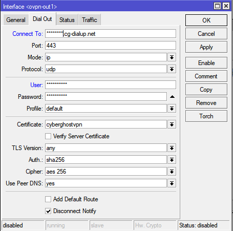

In 7.2rc2 added SHA256 and SHA512 “Auth” values for OVPN menu’s, but still can not establish a connection.
ovpn-out1: terminating… - unsupported auth digest
Any ideas?
