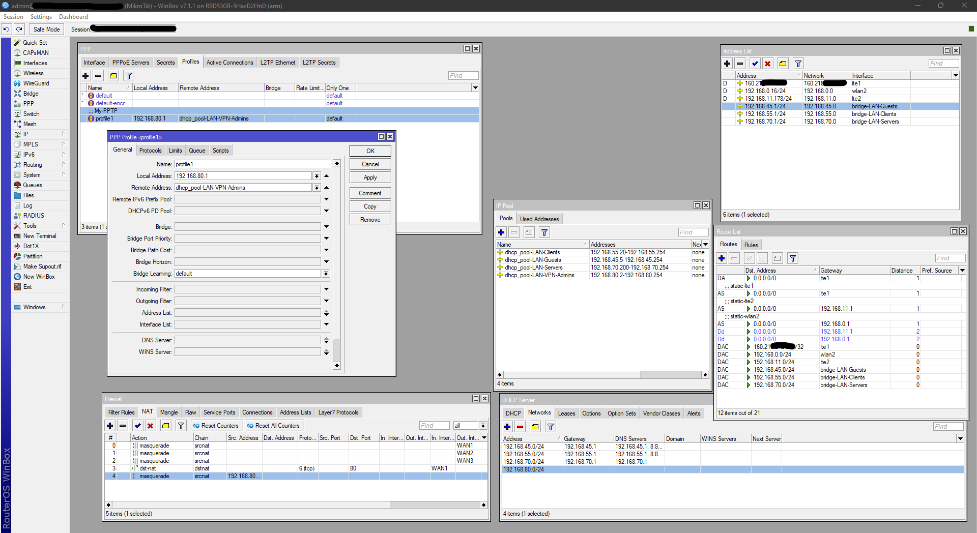

Place A - MikroTik:
lte1, public IP, active VPN server PPTP, VPN Secret user is (on screenshot for details)
Place B - Windows on WiFi my friend (without MikroTik):
wlan - 192.168.100.0/24
Before connection to VPN Server on “Place A” i am visit webpage “https://www.whatismyip.com/” where is show IP from my friend ISP provider.
After connect to VPN Server on “Place A” and I am visit webpage “https://www.whatismyip.com/” now but show IP as my Public IP on “Place A” side.
I want to advise what should I change in the Mikrotik settings so that after connecting to the VPN the connectivity of Place A is not used but the connectivity of the friend on the “Place B” side is used?
You should search for “split tunnel”, this way you can choose whether traffic should be routed through the gateway or over the vpn.
Whether to use VPN as default gateway is client-side config. On Windows it’s somewhere in VPN connection’s IPv4 settings as advanced config, called “use gateway of remote subnet” or something like that. Btw, PPTP is terribly outdated.
If you want your windows client not to use the VPN connection to access the internet, you should unselect on the VPN adapter that is created, under the TCP/IPv4 advanced, the option use default gateway on remote network, that for some reason is by default enabled…

But if you want to block internet traffic on your router, I don’t know a other way to block it in the firewall.
Perhaps you could utilize the “Address List” field in the ppp-profile to create a List of all VPN-users and block the traffic to the internet for this list.
What do you mean?
You can configure the user profile so that the users be automatically added to a specific address list.
Then through that list you can allow or drop whatever you wish..
I think its really easy…
You could as well use the incoming-filter parameter on the profile, and create a custom chain for the ppp users…
Other than that with L2TP/IPsec you can’t push routes to the client.. That is why you have to manually disable the parameter mentioned earlier…
