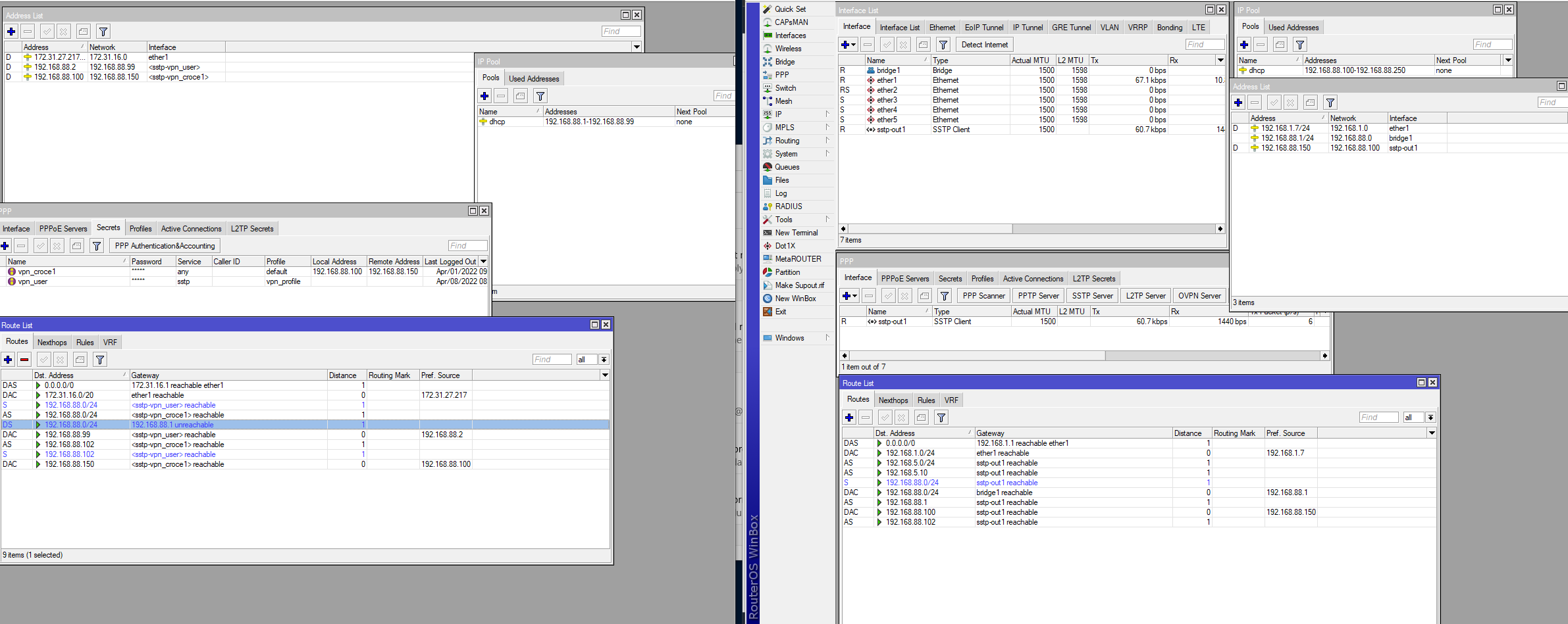

The goal to be achieved is to be in the same local network as the remote controller. controller connected to mikrotik with local ip 192.168.88.222 gateway 192.168.1.1 I must be below
From your last post it seems that the colocated Mikrotik may be placed between your panel controller and the rest of the customer’s LAN, i.e. only the Mikrotik would be directly connected to customer’s LAN, and the panel controller would be connected to another interface of the Mikrotik. Is that the case?

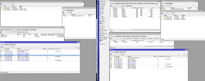

Yes, right. I attach screenshots of the current configurations of chr and remote mikrotik. I can manage the mikrotik remotely but not the controller
