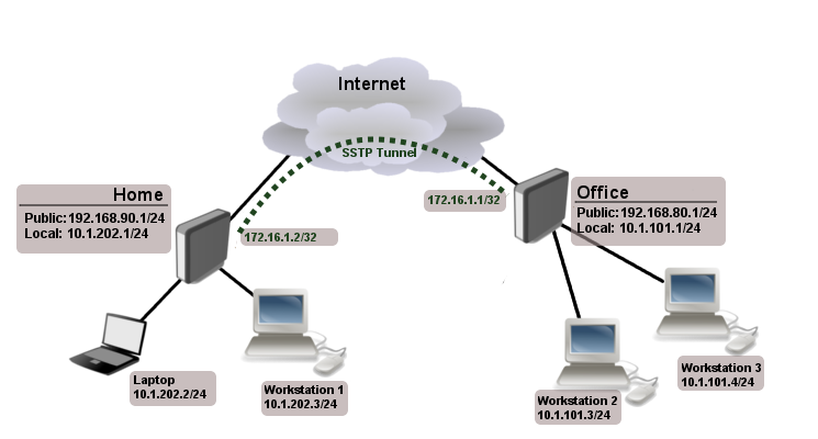

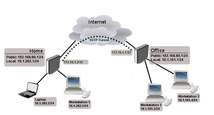

In the attached design the 192.168.80.1:443 I.P. is the vdsl's modem ip from the ISP? I am confused by the three addresses on each mikrotik router . My setup only operates one I.P. address as all ports are bridged so my router listens to 192.168.0.1/24 and the modem on 192.168.0.254. Also because I have a dynamic IP address from the ISP how can I have both routers know when it changes ?
