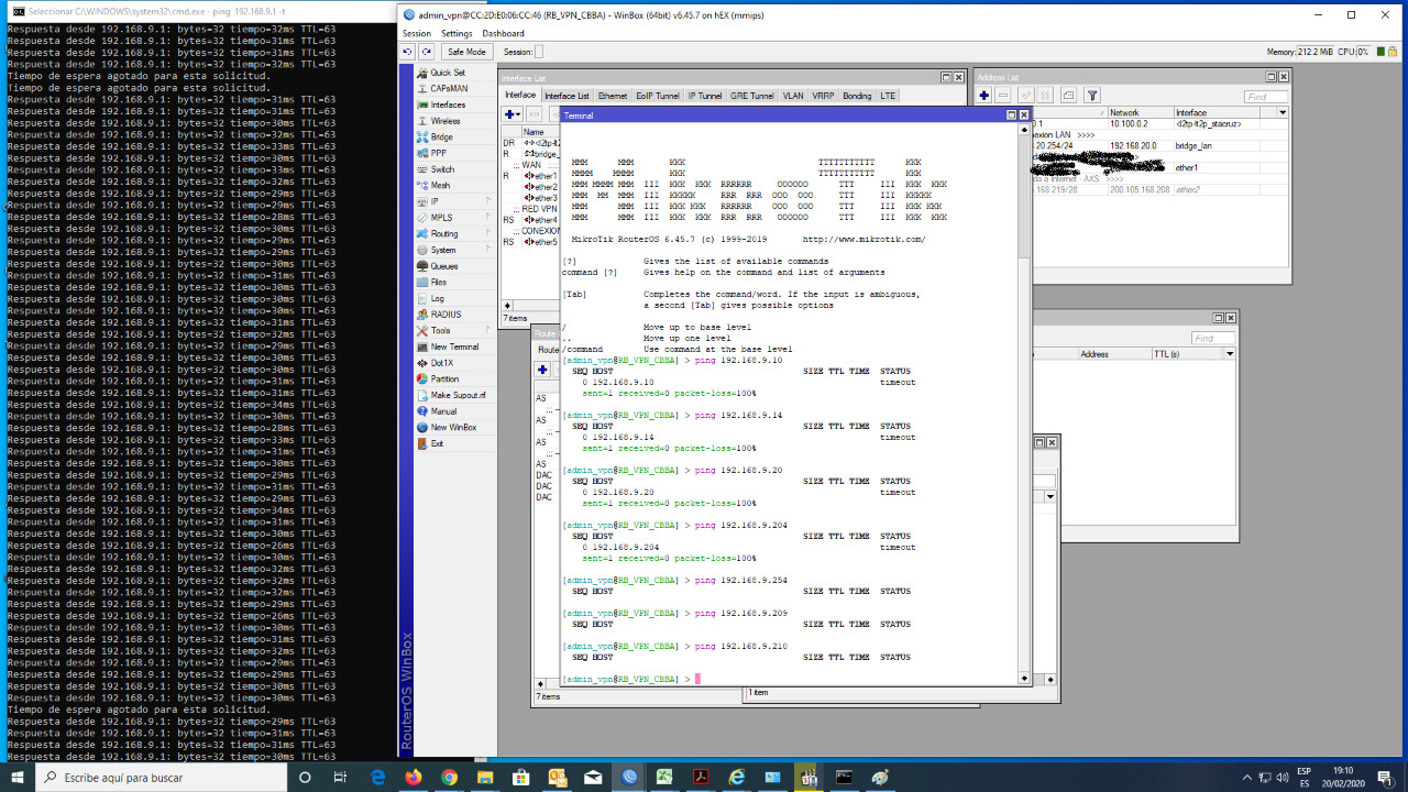

    The detail is that when it begins to have traffic, I have lost packages.
    Test.
  • Cbba equipment: IP = 192.168.20.3
  • Oruro equipment: IP = 192.168.9.1
I attach an image
Note.-
Both are connected directly to the ISP Modem.
The bandwidth is 2: 1 of 100 Mb each.

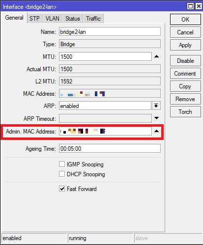

Also: I see the bridge in your config, add Admin MAC to the bridge, because sometimes bridge could change his MAC address, it depends from running/inactive ports. That could have influence to the ping.
Dear angriukas.
Could you tell me how do I add the admin MAC in the bridge.
Here it is.
Dear angriukas:
Thanks for the reply. I have a doubt. The administrator MAC, is the MAC of my computer or PC from which I manage the RB ??
Please excuse me for the question.
Set same value from field “MAC Addess”.
In automatic MAC mode, the bridge normally inherits the MAC address from the port made a member of it, until that port eventually goes away from the bridge. After a reboot, the ports may be added in a different order, hence the MAC address of the bridge may change. During runtime, the address should not change unless the “donor” member port is removed from the bridge.
So by copying the dynamically assigned MAC address to the “admin mac” field, you prevent further changes (or you may assign some completely different MAC address). Do not assign an address of anything external that is connected to the bridge. Any MAC address of any of the own interfaces of the 'Tik which is a member port of the bridge is a safe choice.
But I don’t think the MAC change is the reason of packet loss. IPsec doesn’t touch L2 at all (except indirectly, if you’d use EoIP over IPsec, which is not the case).
