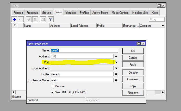

Greetings, I have a rb4011 computer with an ipsec vpn responding, I would like to change the default port that the service has to another port such as 55555 and not use 500 or 4500, since the internet provider has port 500 blocked with your firewall
I never used any other than the default ports, but perhaps, this is the setting:
Greetings thanks for answering, I have certainly carried out several tests in what you indicate, although I do not see results, only that I see that it uses port 4500 when changing it where you indicated, I ask you where you indicated the change, you do it on the server or on the client to get an idea and retest
From wiki txt, the port option is only half of the solution:
Sub-menu: /ip ipsec peer
port (integer:0..65535; Default: 500) Communication port used (when router is initiator) to connect to remote peer in cases if remote peer uses non-default port.
Seems to me RouterOS lacks the other half of solution, being responder and listening on non-default port. Hackish this can be accomplished using dNAT rule
