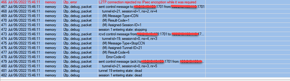

In the log on Mikrotik writes error: L2TP connection rejected no IPsec encryption while it was required.

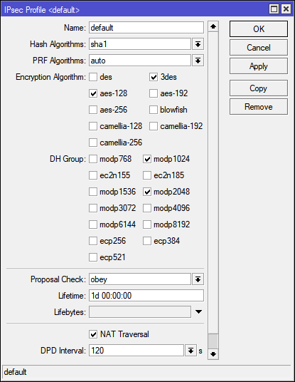

/ip ipsec profile:
dh-group=modp2048,modp1024 dpd-interval=2m dpd-maximum-failures=5 enc-algorithm=aes-128,3des hash-algorithm=sha1 lifetime=1d name=default nat-traversal=yes proposal-check=obey

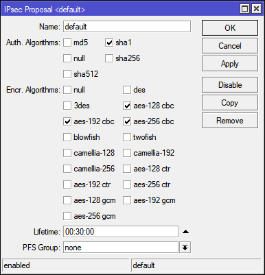

/ip ipsec proposal:
auth-algorithms=sha1 disabled=no enc-algorithms=aes-256-cbc,aes-192-cbc,aes-128-cbc lifetime=30m name=default pfs-group=modp1024
You should enable logging and see what is the strongest encryption and authentication algorithm offered by Windows. Also something is telling me that WIndows do not support pfs by default and you need PowerShell to tell them otherwise.
for Android, I did not specifically configure anything on the router, it worked automatically
These are my default profile settings (in the attachment)

/system logging add topics=ipsec,!packet
Then run /log print follow-only file=ipsec-start where topics~“ipsec”, make a single connection attempt from the client, stop the /log print …, download the file ipsec-start.txt and look for “proposal” in it.
Here is what I get
Unfortunately you have to open the terminal window and use the text commands I gave. The GUI will not show you what you need as too many lines of log are generated to fit into the memory buffer.
I’m trying to connect but no new entries appear
Now press Ctrl-C and open the file ipsec-start.txt that has appeared in the file list.
