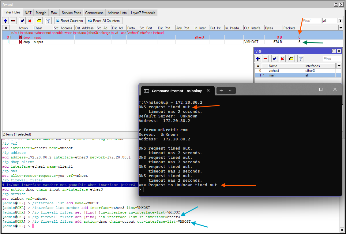

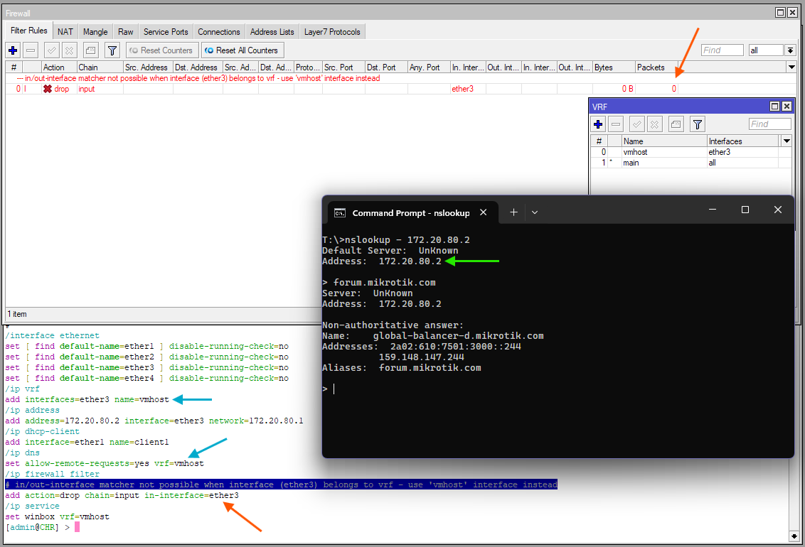

Yep, it says right there, in-interface and out-interface. But also only that! What still behave normally are the in-interface-list and out-interface-list matchers! Let's see some tests:
In this test configuration, ether3 is in VRF vmhost with a static IP address 172.20.80.2. Both DNS and WinBox services are set to listen on the vmhost VRF. As expected, the input drop rule with in-interface=ether3 doesn't work, and DNS queries are processed normally, with the FW rule counter not incrementing. WinBox using 172.20.80.2 works too, but is not part of the screenshot.

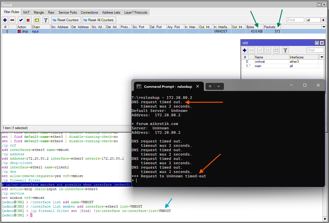

But now I just have to create an interface list and put ether3 in this list, and use in-interface-list=VMHOST in the rule:
The rule now properly drops incoming requests on ether3. DNS queries (and WinBox using IP address) no longer work.

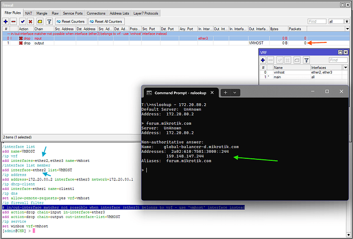

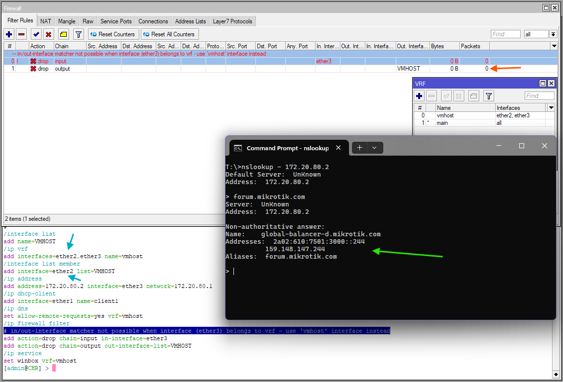

EDIT: To confirm that the interface list does not pull in all interfaces of the same VRF, the following test adds ether2 to the VRF too, and switch the interface list membership to ether2. The drop rule does not affect ether3, and the router can answer DNS queries and accepts WinBox IP connections:
Which means out-interface-list=VMHOST only acts on ether2, and not on the other member of the VRF (ether3).
