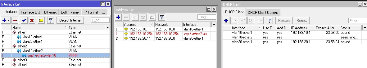

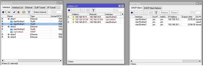

I am attaching the configuration in both graphic and command form. Look, my problem is as follows: I receive the VLANs through the Ether1 interface and, if I request a DHCP client, it provides me with an IP (we could say that I receive both VLANs through that interface, or so I suppose). Now, I want one of those VLANs, which in this case is VLAN 10, to pass through the Ether2 interface and thereby obtain an IP from the range. With that IP from the range, I want to configure VRRP.
My problem is that Ether2 is not taking VLAN 10. The only way for it to take VLAN 10 is by adding it to a bridge, but if I do that, VRRP will not work on Ether2 or on VLAN 10 that is directed to that interface. Is that clear?

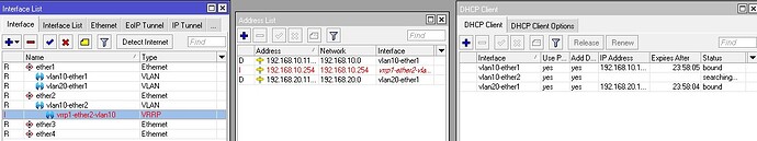

The VRRP interface should not listen on ether2, rather it should listen on vlan10-ether2.
Alright, but VLAN 10 on Ether2 doesn't get an IP, and if it doesn't get an IP, VRRP won't activate. Do you understand why? I can't figure it out.

If your VRRP interface is using an IP address in the same subnet as the master interface (192.168.10.0/24), then the network (192.168.10.0) and subnet mask (/24 or 255.255.255.0) has to match.
The network for the IP address 192.168.10.254 should be 192.168.10.0, not 192.168.10.254.
If you were to use an address from a completely different subnet (172.16.25.10), then you could get away with using a /32.
(EDIT: when the network and IP address are the same, that means the netmask is 255.255.255.255 or a /32 (all 32 bits masked). All the rest of your IP settings presume a subnet mask of 255.255.255.0, or /24 (24 bits on).)
I don’t understand your response :frowning:
I made a typo and put 192.168.0.x instead of 192.168.10.x (post edited), but my point still stands.
Your vlan10-ether1 interface’s IP address is 192.168.1.11x with a network of 192.168.10.0. Your vrrp1-ether2-vlan10 is 192.168.10.254 with a network of 192.168.10.254. The network should match that of vlan10-ether1 and should be 192.168.10.0, not 192.168.10.254. See the second window in the screenshot you sent us (look at IP → Addresses).
