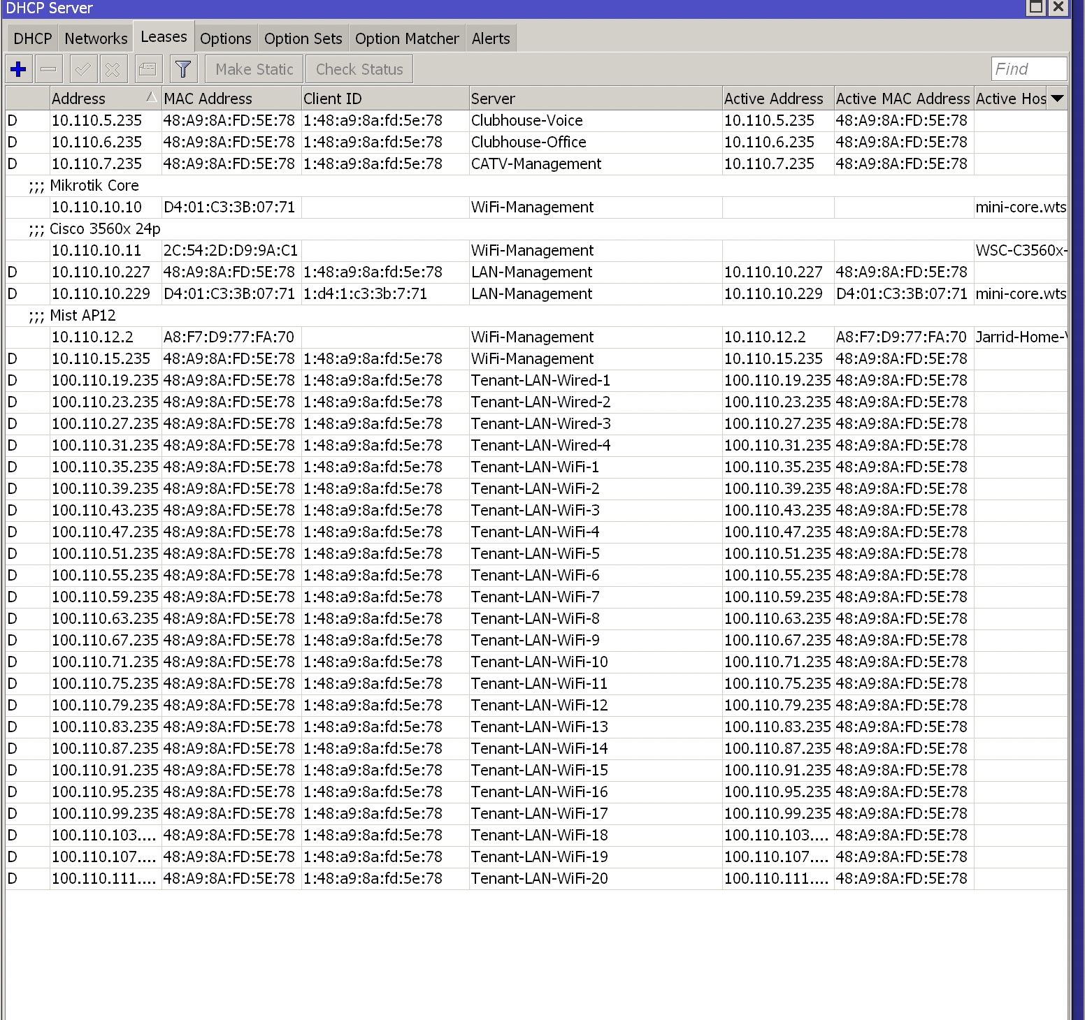

So, I have enabled VLAN filtering on both routers and the aggragate switch and trunked all ports including the LAN bridge, and now it appears to be working, but the connection to the routers doesnt seem as table as before. Also the DHCP table is still flodding. I dont think this is an issue with the VLANS, it appears to be some sort of discovery happening, maybe its a bug?

Its funny you say that, when I decided to hit it again lastnight, I noticed the alerts as well and thought to myself. I am actually going to try that next, I just want the stupid dynamic leases to stop popping up lol.
My man! That was it, I moved them to the VRRP interfaces and it has stopped the flood of DHCP entries. I still wonder why it was causing that, its kind of odd.

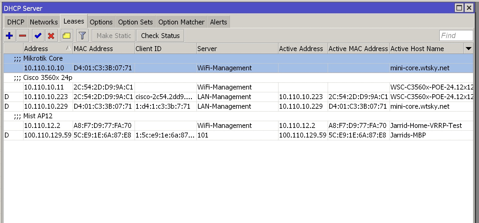

I believe it may be due to that fact that I moved the DHCP servers over to the VRRP interfaces as well. This means all of the alerts we added were going to an interface not bein used the same way I guess. Personally, I didnt even realize that we did use dhcp alerts until I exported the whole dhcp server list to reimport them the way I wanted them. I changed them all to the vrrp interface, and they seem to be functioning properly now!
