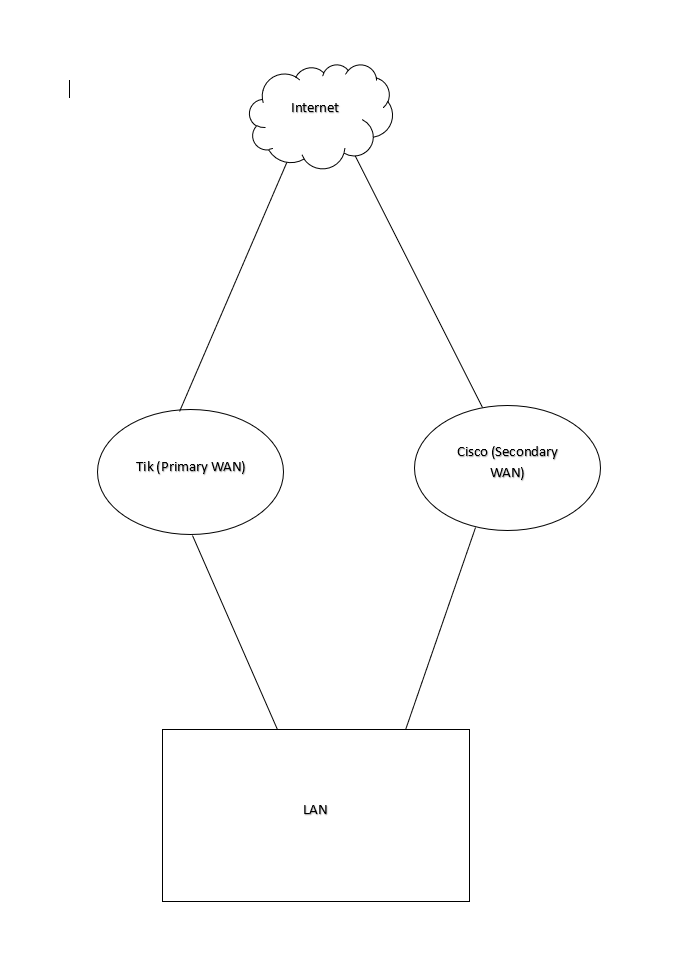

@ primeyeti,
can you show us your drawing?

Diagram this out. Are you deploying 2 Tik routers or just 1? Do you have full control of both routers? For a usual VRRP, the VRRP instance needs 3 IPs on that same subnet. 1 for each router, and 1 as the VRRP interface.

I’m presuming OP each router has its own/different WAN & and the WANs are not otherwise connected locally. Diagram would help — since if both routers have the same upstream WAN on same subnet OR if two different WANs do exist on both routers via some VLAN/etc… those likely have different answers here…
Image is attached. I didn’t attach one originally since, as you can see, it’s not a complicated setup in the slightest. Also apologies for my drawing. I don’t do network drawings often :laughing:

P.S. The drawing is supposed to show the interfaces from Tik to LAN and Cisco to LAN as the VRRP enabled interfaces but I’m an idiot and forgot to illustrate that…
Sounds reasonable plan to me. Assuming that cisco and RouterOS’s respective VRRP sync – it should, but never tried that…
