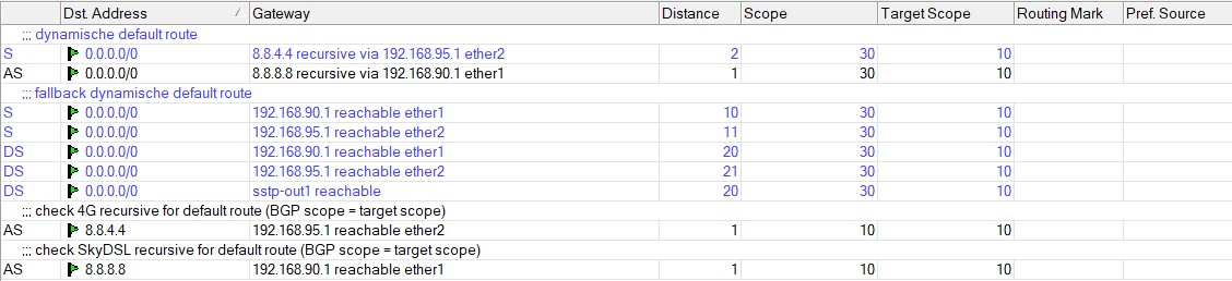

My “simple” implementation … (distance 10,11 is failover if checks don’t work, distance 20,21 are DHCP routes used with ‘other’ ISP connections )
“Failover” requires different distances. (Not like “load balancing”)
add check-gateway=ping distance=1 gateway=8.8.8.8
add check-gateway=ping comment="dynamische default route" distance=2 gateway=8.8.4.4
add comment="fallback dynamische default route" distance=10 gateway=192.168.90.1
add distance=11 gateway=192.168.95.1
add comment="check 4G recursive for default route (BGP scope = target scope)" distance=1 dst-address=8.8.4.4/32 gateway=192.168.95.1 scope=10
add comment="check SkyDSL recursive for default route (BGP scope = target scope)" distance=1 dst-address=8.8.8.8/32 gateway=192.168.90.1 scope=10
Thank you so much, I copy pasted it, modifying 192.168.90.1 to 71.146.120.1, then 192.168.95.1 to 192.168.12.1.
That was it, it immediately worked when I tested. Yanked the fiber out of the ONT to simulate the ethernet still being powered from ONT to RB, but the internet is suffering an “outage” on ISP1. Within 1 minute it switched to my ISP2, then after I reconnected, it took about 1 minute then it switched back to ISP1/fiber ONT.
No need for complex mangle or anything. You are amazing, thank you for your time. Do you accept donations via crypto?
