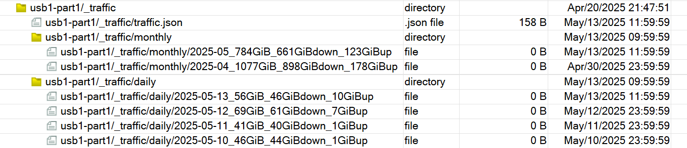

This is how it looks:

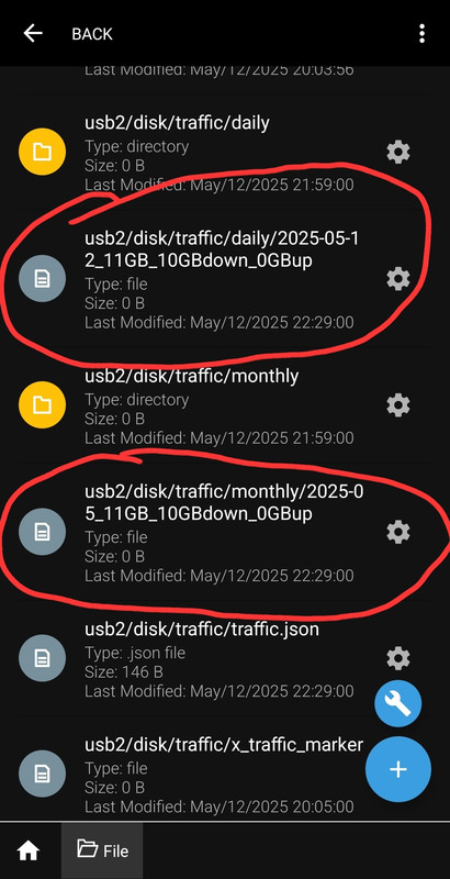

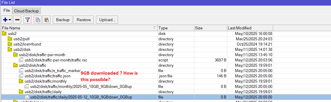

EDIT: Found some weird stats when script is executed.. How is possible ether1 to show 4.X GB downloaded, but after executing the script it shows 9GB downloaded?
Some bug or?

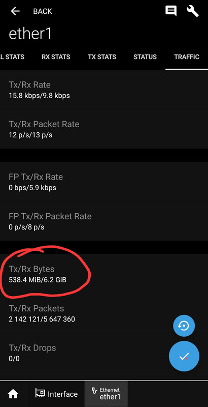

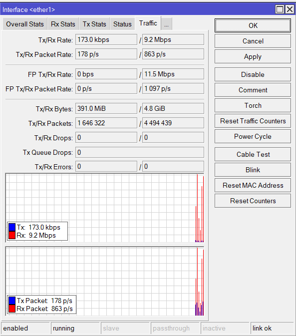

Have you reset traffic counters or rebooted the router since executing the script for the first time? The counters on the interface itself are in-memory only (4.8GiB in your example).
If you don’t mind losing some statistics, try deleting traffic.json and then running the script multiple times. The values should match the interface counters until a reboot or a reset.

No i dont have reset the router! On first executing the script shows 4GB download and on second iteration it showed 9GB. From where it get that info i dont know!
This is data from now:
Makes no sense this numbers!
Upon looking closer at your first screenshots, I conclude that you made some changes to the script. I see two issues. First, the timestamp on x_traffic_marker is exactly the same as on traffic.json (and other files), 20:05:00. This can only be like that on the first ever run or after a reboot. In all other cases the timestamps should be different.
Second, the marker file is supposed to be in the root top-level directory, which is RAM. By placing it on USB drive, you are defeating the purpose of the marker file, which is to disappear on reboots.
Speaking of which, does your router have a directory (actually, disk) called “flash”? If yes, then you don’t need to (and shouldn’t) do anything with the “marker” variable.
I suspect the changes you made cause the script to think that router was rebooted upon every execution. Because that’s when it adds interface counters as is, without doing any calculations with the previously stored counters.
The numbers will continue to make no sense. You would need to fix the script, remove traffic.json and the x_traffic_marker, and start over again. The only change you need to make to the original script is the “savedir” variable, that’s it.

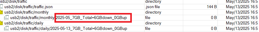

So assumed on your asnwer will revert xmarker file as default, and will start over again. Disk you noted is HDD attached to my router. One strange thing more.. Why script calculates 6+0=7 like is shown in image bellow:
If script “rounds” to full number and dont count MB, they count as 6GB total, because 6+0 is not 7 right?
  • Ignore Total= i was added to script to be more readable to me. Nothing more is changed.

The script doesn’t do any rounding, it just divides bytes by 1073741824 to get gibibytes. RouterOS doesn’t support floating point nor does it do rounding properly. It simply truncates everything after the point, so even 0.99 ends up as 0. But it’s not a big deal for this use case, 0.99 GiB of traffic is nothing for a whole month or even a day.
The reason why you see 7 = 6+0 is because each digit is divided independently, total, download, upload. If I calculated download, then upload, then summed up them, you would get correct math but less accurate data because of double truncating.
