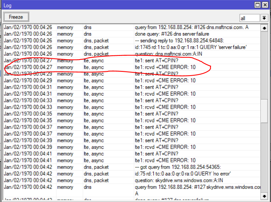

I purchased a WAP LTE US kit and installed a working SIM from a Verizon Jet Pack into the unit but it failed to connect. From the log I’m getting :
CME ERROR: 10
Which appears to mean no SIM. I upgraded to the latest RouterOS and double checked that the SIM is inserted correctly. I removed the SIM and installed back into the Jet Pack and it works fine. I’ve sent a support request in and it’s been four days with no response.

I also have this same device and have the same scenario,WAP-LTE Kit RBwAPR-2nD . I opened a support ticket with Mikrotik but have not heard back. It seems like maybe there is a bad batch of these devices. I am requesting a refund from my distributor. I’ve attached a screenshot of the logs.
version 6.42.1
