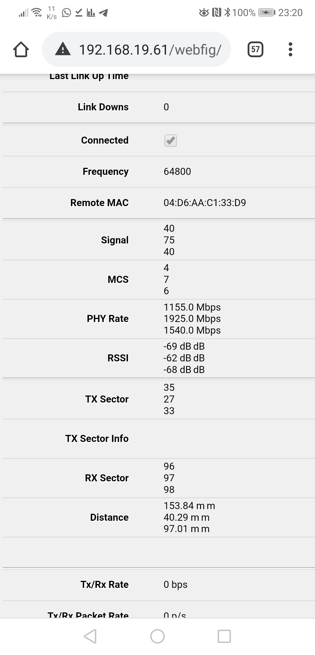

We had one running three clients, today we moved it up by 70cm and added an additional client and had major performance issues.
So we removed the furthest left client and twisted the sector to the right slightly, there is no more than a 40 degree spread.
1 client is 40m, 2 is 90m, 3 is 140m

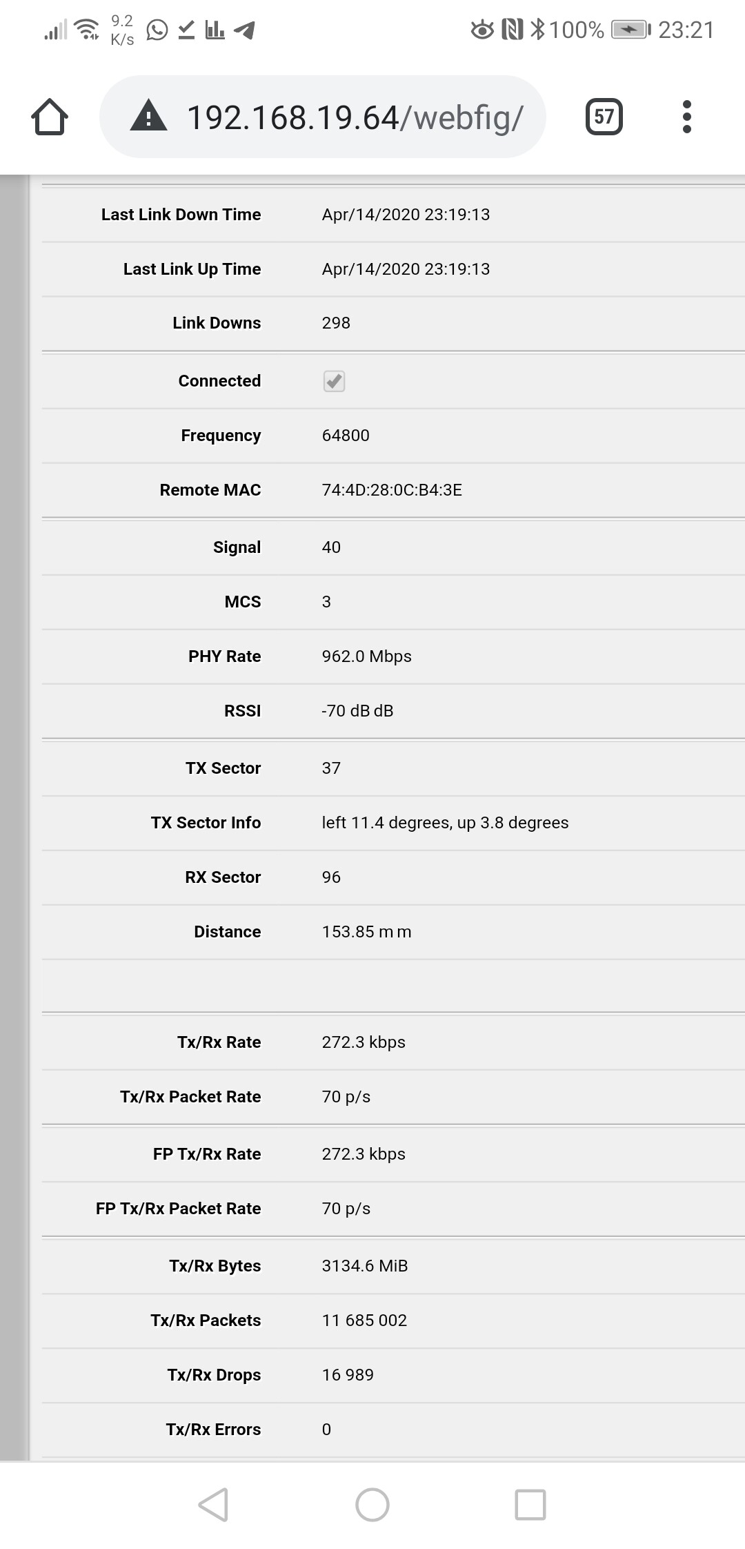

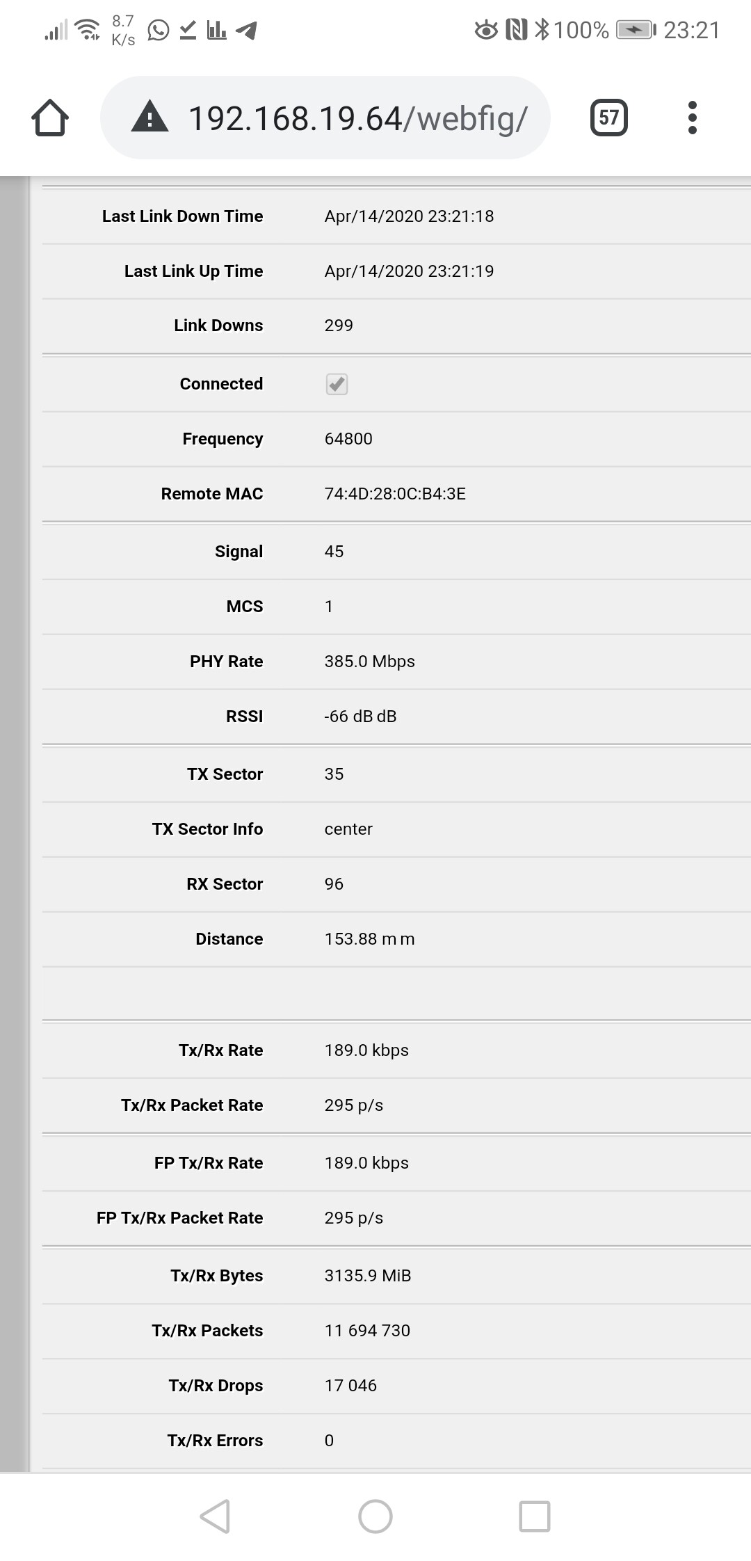

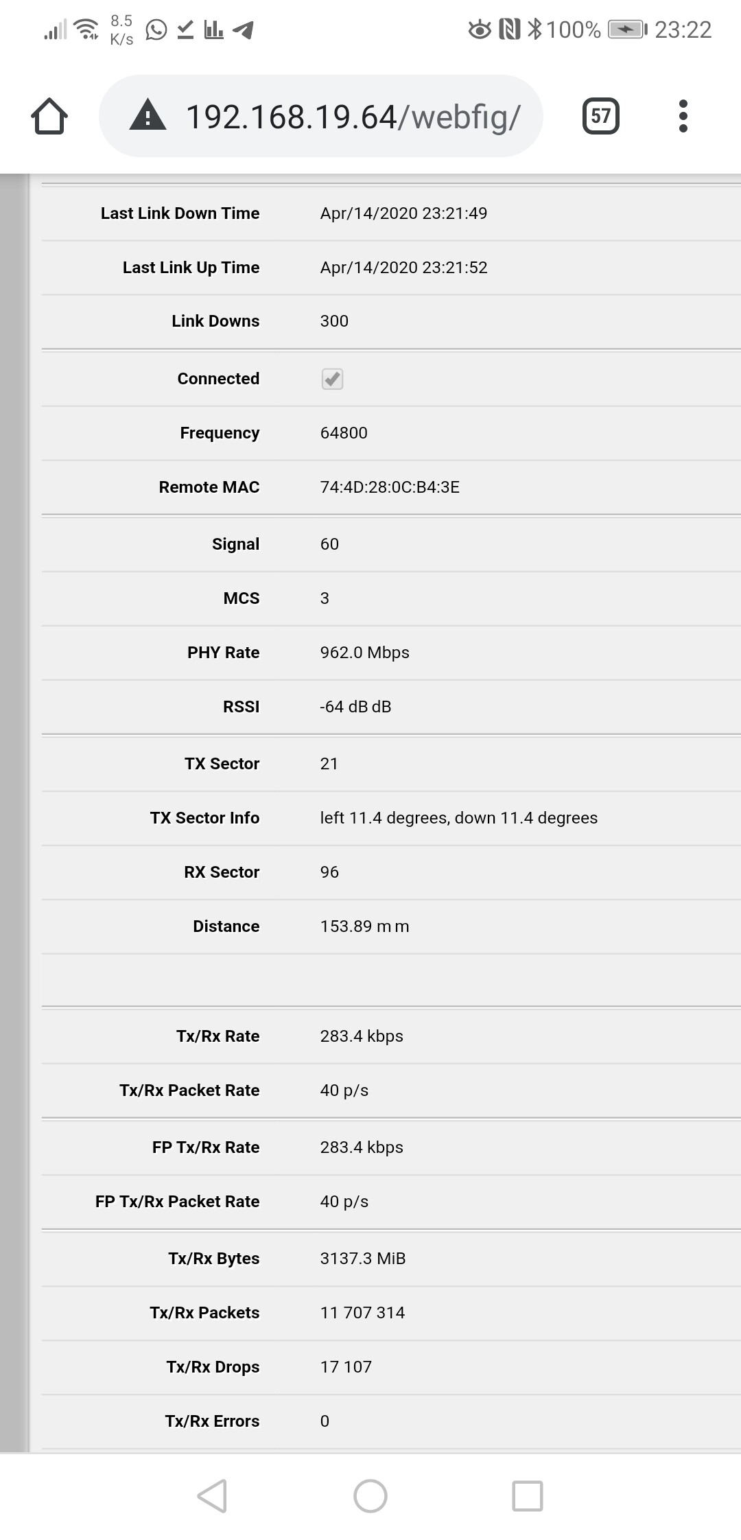

This has been running 3 people perfectly, but now the mcs rates our bouncing all over. The TX is going from centre to 23 degrees left to 11 degrees right and back to center. All in the space of a few minutes. We’ve had hundreds of drops since this afternoon.
All radios have been upgraded to the latest beta and back to latest stable.
Running on 64000.
Just seeing what other people have experienced?
The elevation is equal for the two furthest clients, the nearest who has the strongest signal is 5m lower.
I’ve also tried locking the furthest cpe to a specific TX sector rather than auto, but no. Luck!
