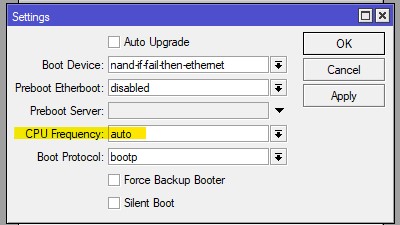

We have just encountered similar problems withRBD52G-5HacD2HnD and in the end there was a very simple solution, in Routerboard > Settings just change the CPU Frequency setting to auto
