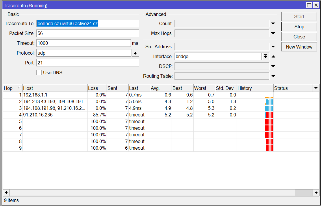

OK, you did UDP traceroute, which is not really representative for your case (any firewall may let TCP 21 = FTP through, but not UDP 21 which doesn’t map to anything).
But even if it is representative, it’s some host on active24 network edge which seems to drop connection, the last node which replied (91.210.16.236) maps to DNS name nix1-xe.active24.cz. I don’t see how a proxy, run on your router, could change this (assuming that your router does SRC NAT all other devices beyond your router will see same src-address both if using proxy or if using “straight” NAT-ed connection.
So no, I still don’t see how using a proxy changes what you see.
