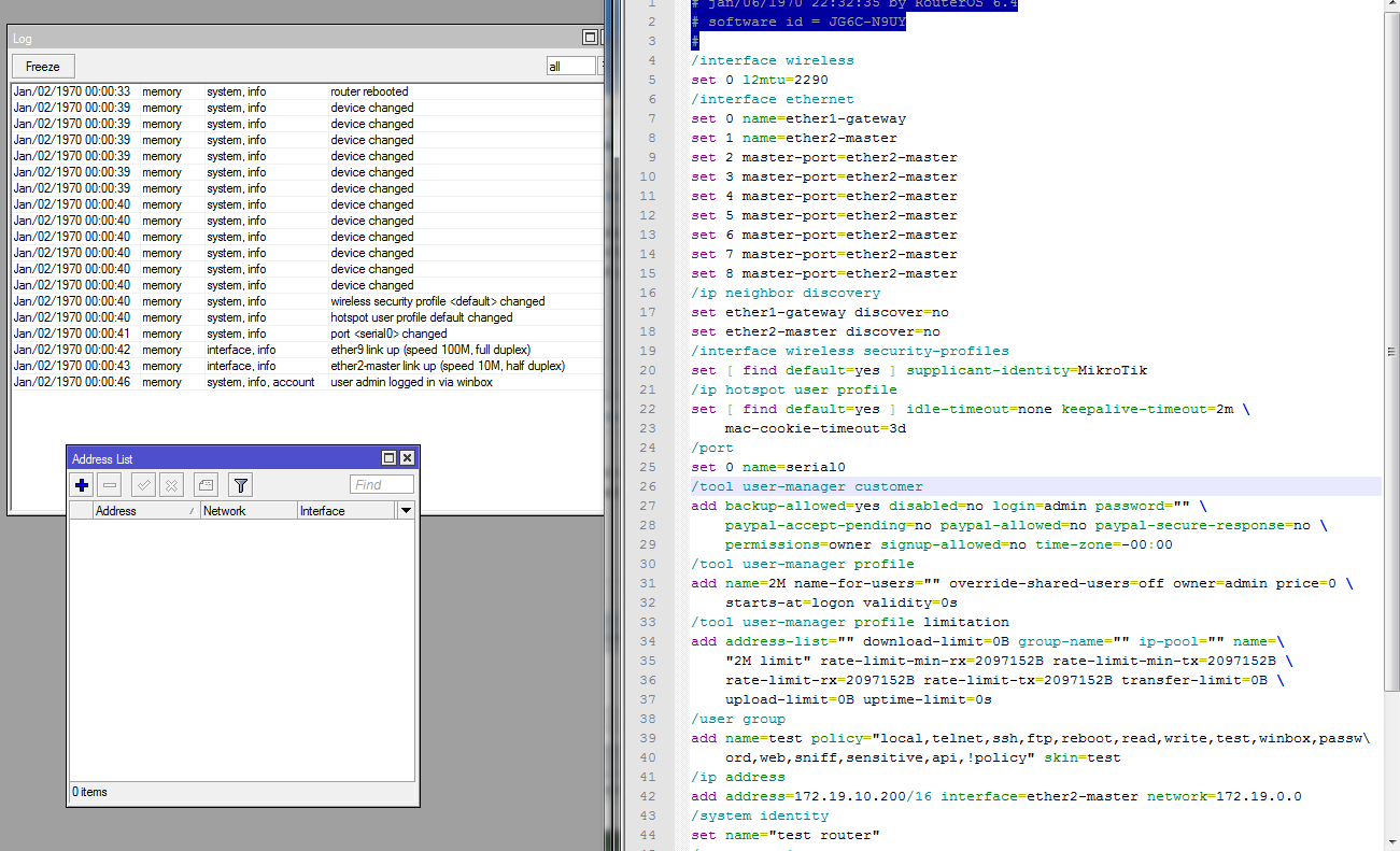

  5. Compare the log to your DefaultConfig.rsc file. This is where I found the problem in my script. As you can see in the screenshot, the log shows a bunch of “device changed” entries that correspond to lines 4-18. Then log shows “wireless security profile” was changed, which corresponds to lines 19-20 of the script. Log then shows “hotspot user…” which corresponds to lines 21-23 of the script. The “port changed” line corresponds to lines 24-25. After that we see that ether9 and ether2-master are both running (because I have things plugged into them, not because of the next line(s) in the script). But after that, there no more logs that correspond to the script. Nothing about user-manager, or user groups, or ip address. As you can see based on the script on lines 41-42, I should have an IP address set on the router, but as you see in the winbox window, the Address List is empty. So, we probably have errors or problems that in the script that are causing it to stop.

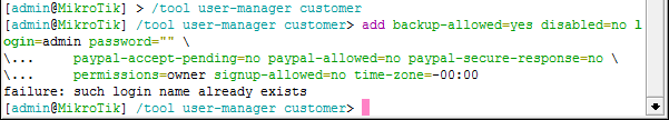

    The next block that should have run (after “port changed”) was /tool user-manager customer, so I’ll copy and paste (you have to right-click and select paste, ctrl+v won’t work) it into a terminal window. As you can see, it throws up an error. So, apparently this block is causing the script to stop.
    So, I’ll try the next block, same thing:
    The “/user group” block also fails because when I reset the config earlier with keep-users=yes, the group still exists.
So, basically I had to go block by block through the script to figure out which ones were causing errors. Depending on the error, I had to either 1) Removed the block of code (as in the examples above because the settings already existed) or 2) Figure out the problem and a solution
