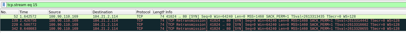

The LTE Modem is Huawei 5G CPE Pro running in Bridge Mode. It’s not really possible for me to inspect traffic on that device because the software is locked down.
I have tried to inspect traffic using packet-sniffer on lte-vlan interface and it there is no response from a remote server after sending SYN.
And this is only happening with some servers. For example, HTTP requests to icanhazip.com work just fine but traffic to anything behind cloudflare(i.e. Anything that is using Cloudflare’s DNS proxy) or Mikrotik Forum or most other sites is getting stuck.
hung.connection.issue.pcap.rsc (237 KB)
