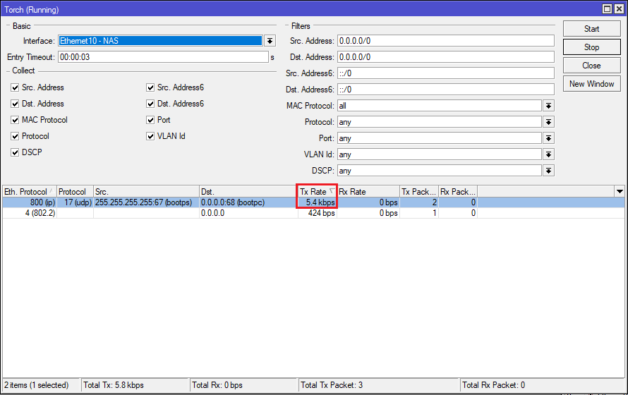

I noticed recently traffic on every connected device, even there is no activity. They are downloading like 5.4-6Kbps on every device. I used torch to track where is coming from and i find out it’s port 67 and 68, i blocked it in firewall but it did nothing. Can you please help me how to solve it ? I have Mikrotik RB4011iGS+ with firmware version 6.47.4

It’s broadcast traffic, so it is clear that it is visible also at interfaces with static IP addresses. Notice that the understanding of source and destination in torch is from the perspective of the outgoing traffic - 255.255.255.255 cannot be a source IP address normally, but torch shows it like that because it shows both Rx and Tx on the same row, so SRC is the address at the router’s side of the connection, DST is the address at the remote side.

As already suggested, use sniff instead of torch, you’ll see the source MAC address(es) of those DHCPDISCOVER requests.
The other traffic shown as 802.2 is likely some flavor of STP.
