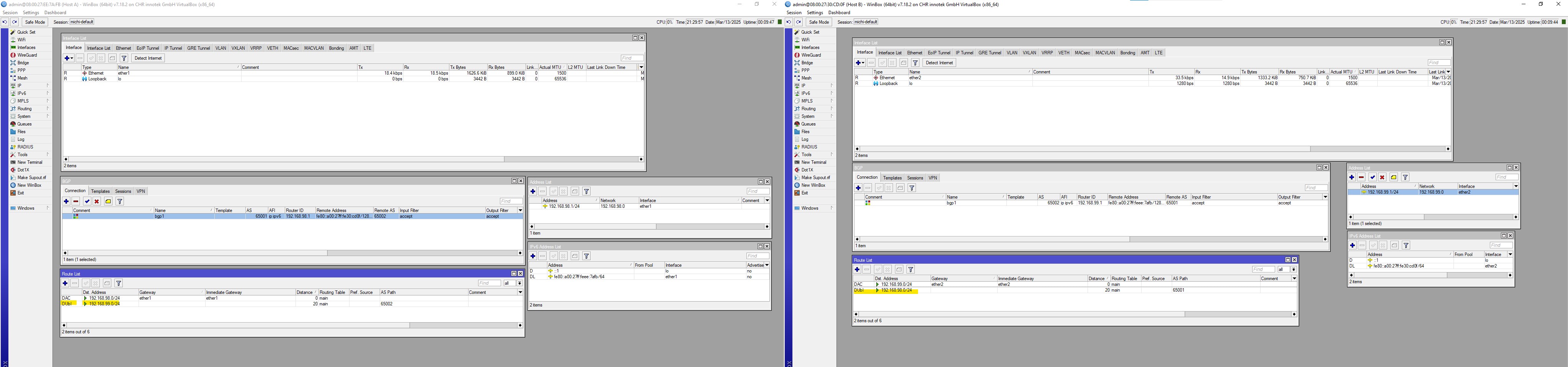

As of today 2025-03-13 in 7.18.2 it is not possible to route IPv4 over an IPv6 BGP connection.
Routes will be displayed on each other router, but is unreachable because of lack of routing via inet6.

To be clear, routing ipv4 over ipv6 do work.
[admin@CCR2004_2XS_111] /ip/route> add dst-address=1.2.3.4 gateway=fe80::de2c:6eff:fec5:a7ff%sfp-sfpplus1
[admin@CCR2004_2XS_111] /ip/route> print
1  As  1.2.3.4/32          fe80::de2c:6eff:fec5:a7ff%sfp-sfpplus1         1
Currently only feature that is not implemented is RFC8950, that allows to advertise ipv6 nexthops for IPv4 NLRIs
