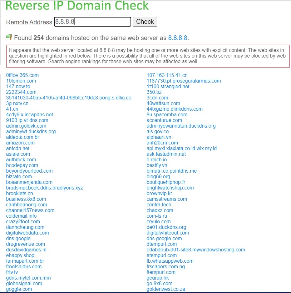

For public IP addresses , try this one: https://www.yougetsignal.com/tools/web-sites-on-web-server/
254 websites on 8.8.8.8 just as exemple

On the example from @bpwl you can see that a single IP 8.8.8.8 have inside dozen of sites, and only one reverse PTR to dns.google.
