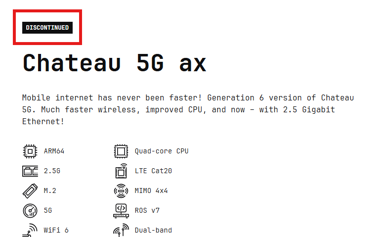

I have not opened some of the newer models to see myself, but AFAIK nothing has a M.2 slot for LTE/5G since the new devices are embedded without headers.
You can use an M.2 adapter to the miniPCIe on some of the routerboard products. Stuff like wAPacR and LtAP will get you >300Mb/s over miniPCIe since they are USB 3.0 But the wAP is only 16MB, and lack AX or BE devices for the Wi-Fi part.
The best you can do is use USB to external modem, which can offer MBIM so it appears same as a one connected via miniPCIe/M.2. Maybe they have plans from some wAPax "R" with a M.2 slot for 5G, which allow you use your modem module. But it still be better if they sold one with a decent worldwide modem as a higher end offering.

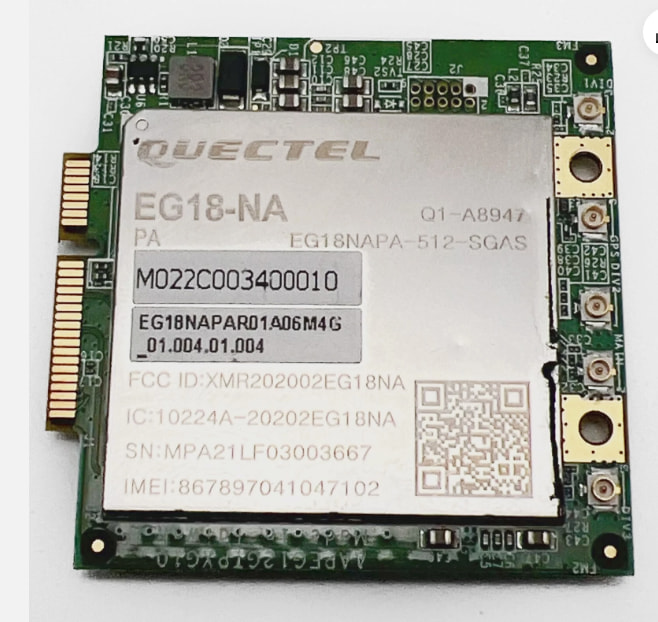

but really wish that mikrotik rolled out something like the LHGGM&EG18-EA ( if they make the NA variant!! yummm )
but with an empty m.2 B-key slot so we can furnish our TELIT or Quectel 5g modems
I saw those on the roadmap. I didn't know they are shipping.
You might want to check with the distributor to see if they offer a "R" model without modem, or perhaps they order them that way, IDK.

thankfully i use ATT so i think i will be good, my only concern is that mikrotik list on the device model number, the soldered version of the quectel chip, so i guess there is no way to disable it if it is soldered, another thing is that they list an m.2 slot but do not state if it is KEY B ( modem ) or just a SSD M.2 slot
if they offer the lamp with no modem just the m.2 modem socket it will be awsome,
they do that already with some WAP models ( mini PCIE slot )

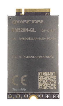

you can search a mikrotik with a usb3 port, capable to accept an adapter m2 to usb3 (i'm using a waveshare one)so you can select the version of quectel or fibocom modem, or in the future upgrade it.
be careful when you choose the modem, especially a quectel one, due to bands restrictions by 5g/bts
quectel has many 5g models, some are better, depending on area you'll use it.
I made a mistake with a rm520nGL (gl means global), but it is the "light version" of RM520 with less radio capablity, and less CA band potential aggregation.
If you live in EU, prefer the EU version rather than a global for worlwide, and remember NOT to buy an AP version (special version without usb bus)
