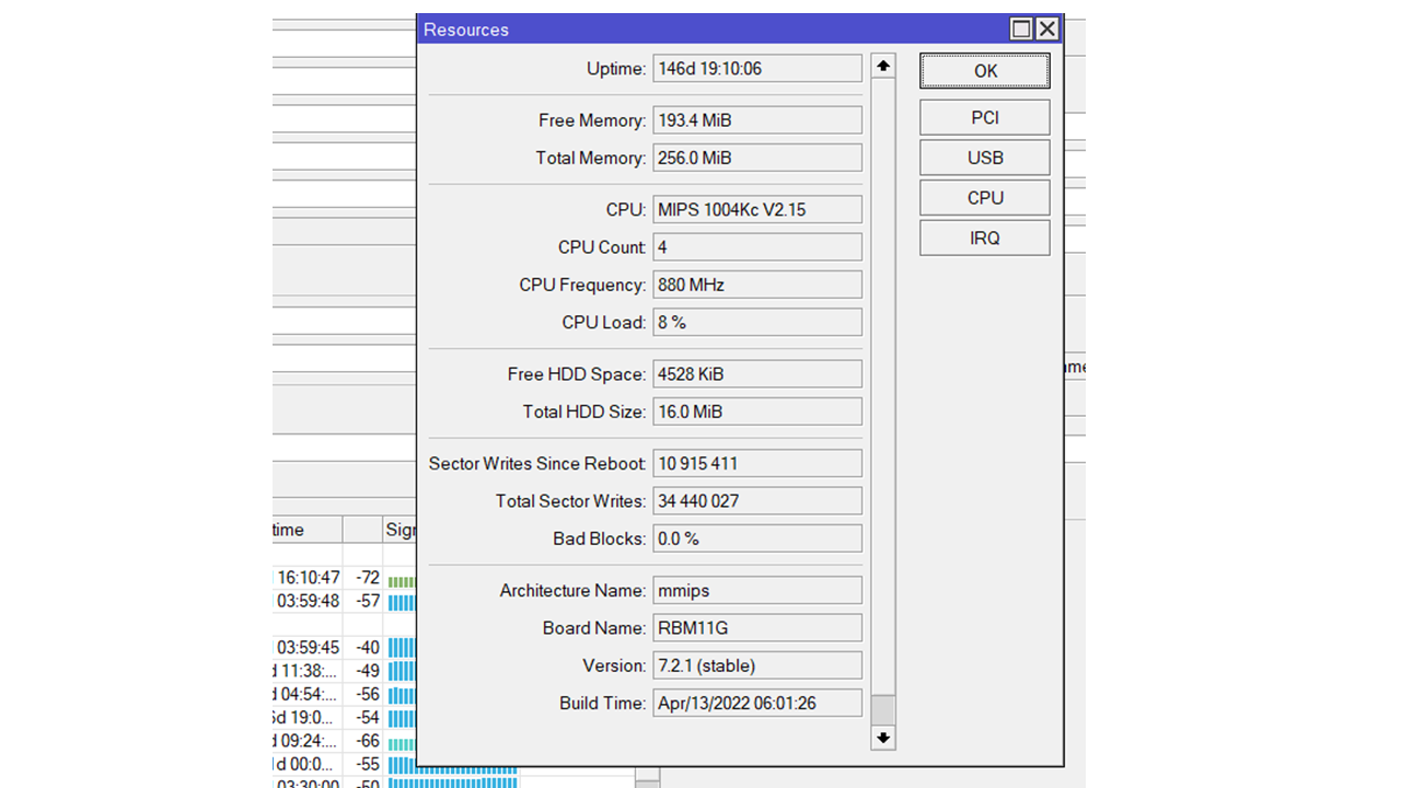

We already have enough ram in RBM11G (256Mb)
Enough to install Wave2
