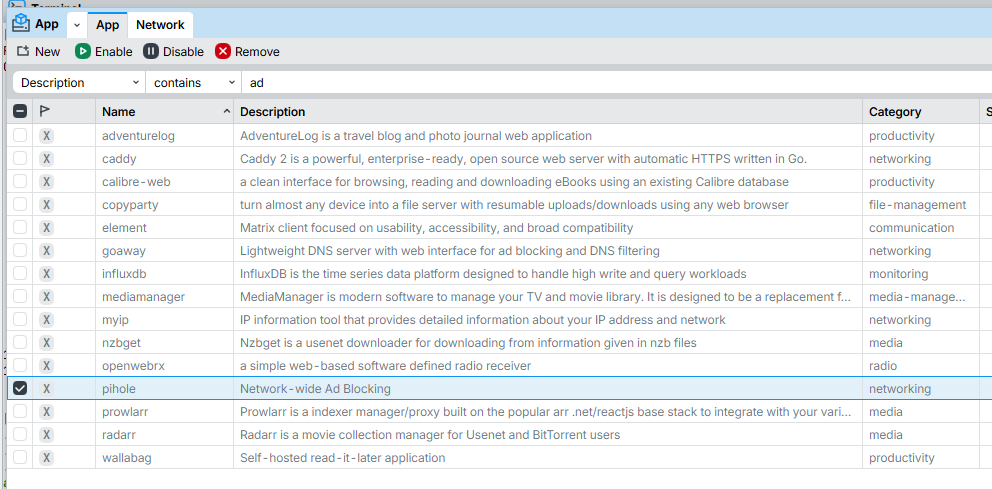

Where is AdGuardHome app?
According to:
https://adguard-dns.io/en/blog/adguard-home-mikrotik-mfm-catalogue.html
https://mikrotik.com/mfm/software
Adguard is certified for MikroTik so i would assume that it will be avaliable via /app, but it seems i can’t find it

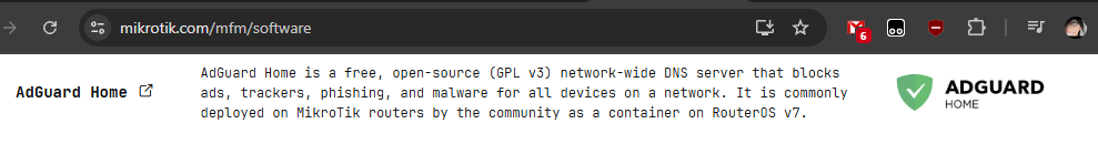

I would assume it by beeing pointed as software on mikrotik webpage
even there it is mentioned: It is commonly deployed on MikroTik routers by the community as a container on RouterOS v7
And the link on the left for "AdGuard Home" points to the same link mentioned above.
Okay, so? You could say same for other 84 apps avaliable under /app.
I don’t quite understand your comments, I nevers said it is unabaliable under MIkrotik, but having it as app would be easier
ON topic:
Not exist (actually).

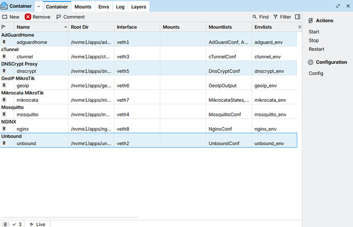

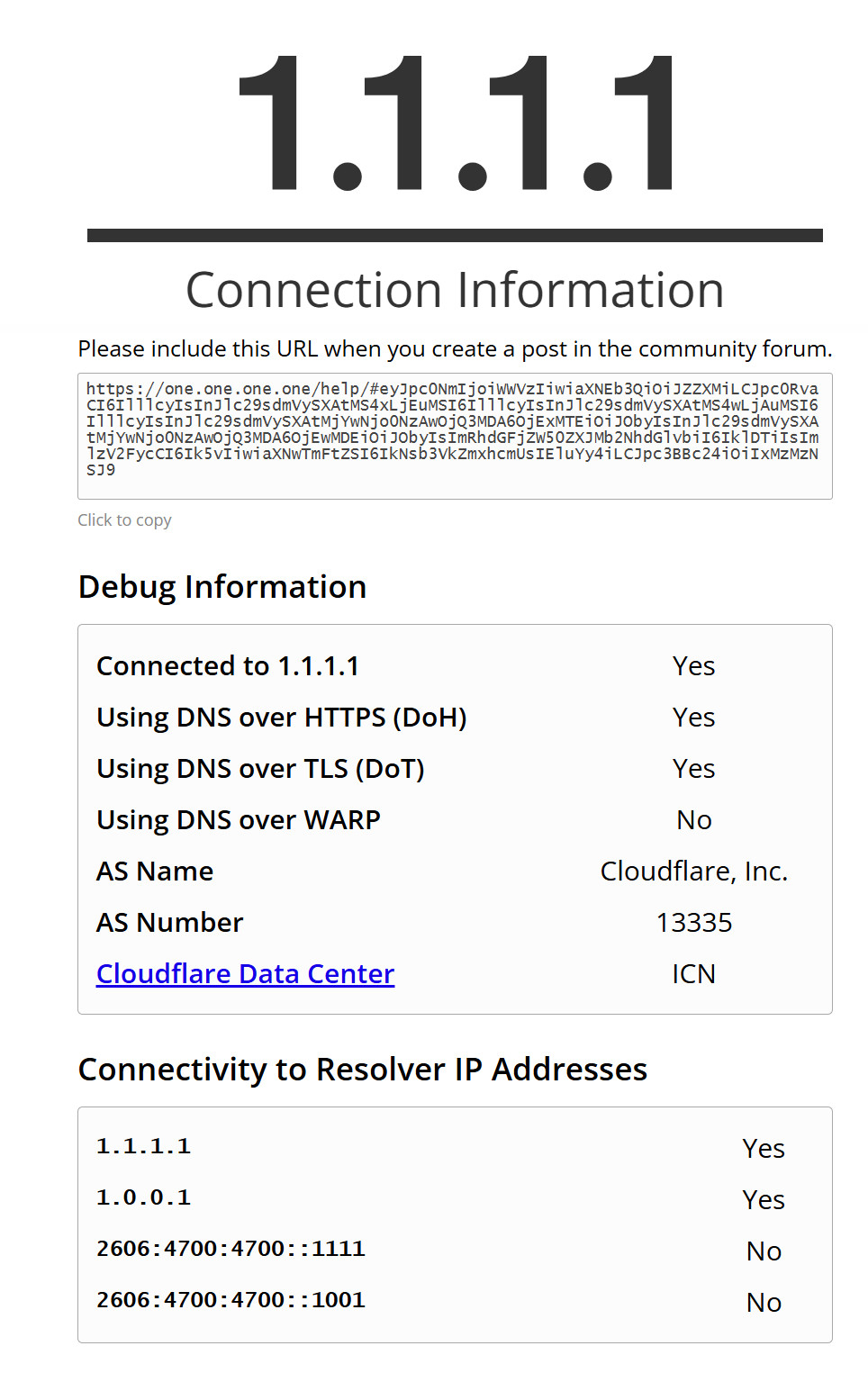

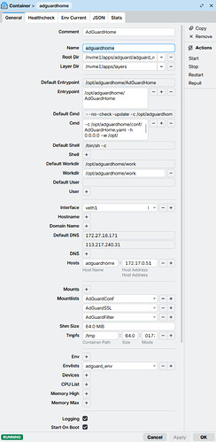

AdGuard Home runs very well in container of RouterOS v7. But it is some difficult to use the LetsEncrypt certificates to run DoH and DoT services.
Thanks, yaml itself is easy, what i ment is that, /app is poorly documented, and it is more trial and error thatn straght forward configuration, e.g. documentation is not reflecing /app structure, managing dynamic veth is annoying when recreating apps, modyfying/updating app or if you stop app and reboot ros your custom app will dissapear from list, but container itself will stay, etc.
In general as much as I like contept of /app, current implementation is horrible and nowhere near production ready
DoH and DoT = dnscrypt, unbound

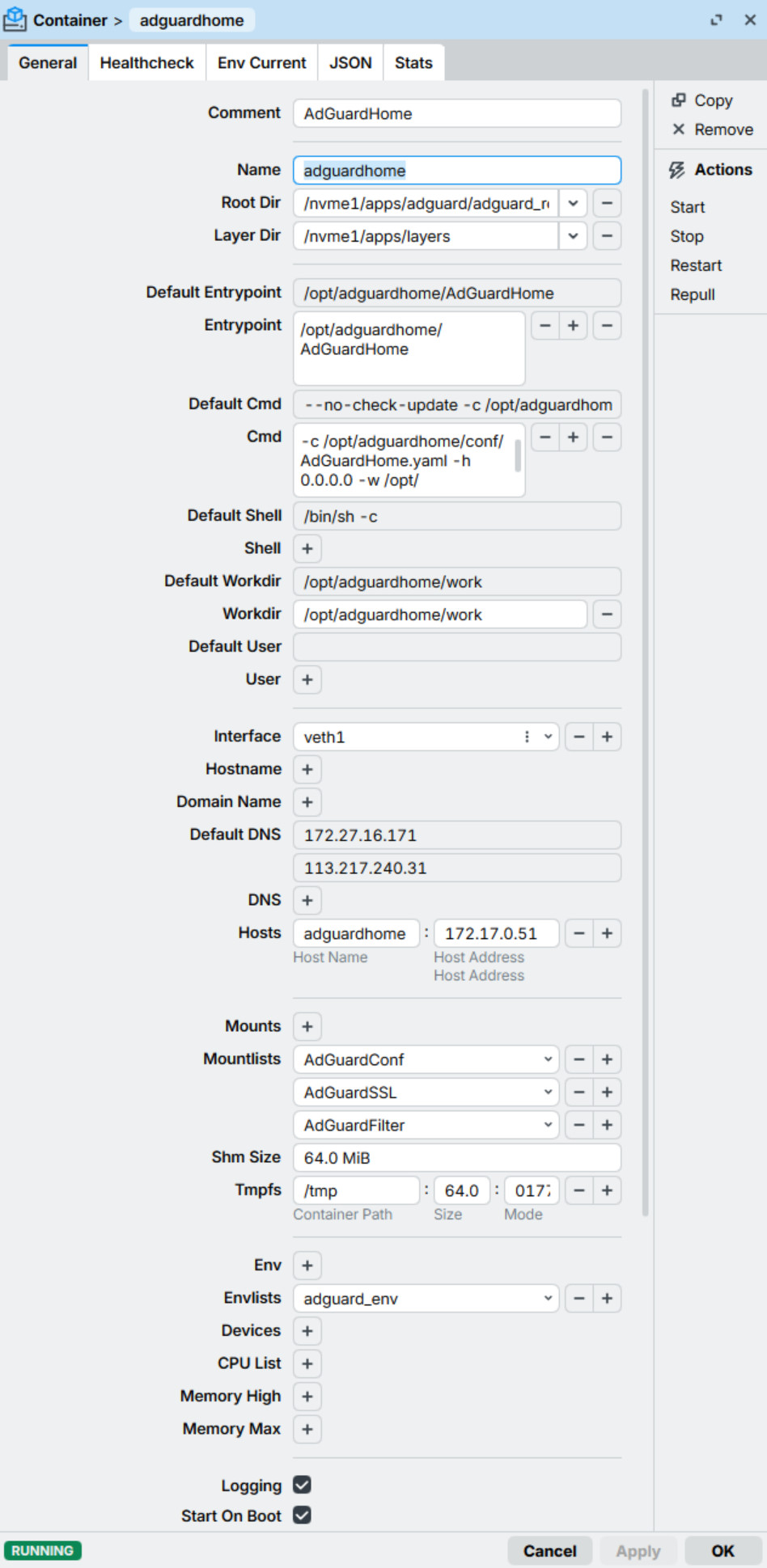

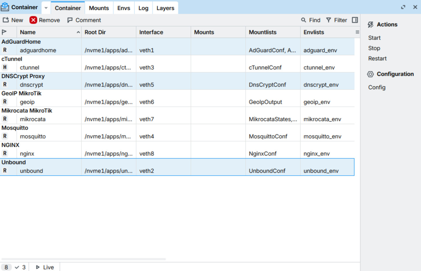

AdGuadHome
/interface veth
add address=172.17.0.51/24 comment="AadGuard Home" container-mac-address=\
    64:CF:8A:11:F9:95 dhcp=no gateway=172.17.0.1 gateway6="" mac-address=\
    64:CF:8A:11:F9:94 name=veth1
add bridge=bridge2 comment="AadGuard Home" interface=veth1
/container
add check-certificate=no cmd="-c /opt/adguardhome/conf/AdGuardHome.yaml -h 0.0\
    .0.0 -w /opt/adguardhome/work" comment=AdGuardHome entrypoint=\
    /opt/adguardhome/AdGuardHome envlists=adguard_env hosts=\
    adguardhome:172.17.0.51 interface=veth1 layer-dir=/nvme1/apps/layers \
    logging=yes mountlists=AdGuardConf,AdGuardSSL,AdGuardFilter name=\
    adguardhome remote-image=adguard/adguardhome:latest restart-policy=always \
    root-dir=/nvme1/apps/adguard/adguard_root start-on-boot=yes tmpfs=\
    /tmp:64.0MiB:01777 workdir=/opt/adguardhome/work
/container envs
add comment=AdGuardHome key=TZ list=adguard_env value=Asia/Seoul
/container mounts
add comment=AdGuardHome dst=/opt/adguardhome/conf list=AdGuardConf src=\
    /nvme1/apps/adguard/adguard/config
add dst=/opt/adguardhome/work/data/filters list=AdGuardFilter src=\
    /nvme1/apps/adguard/adguard/filters
add dst=/etc/ssl/acme list=AdGuardSSL src=/nvme1/apps/adguard/adguard/ssl
AdGuardHome.rsc (1.2 KB)
