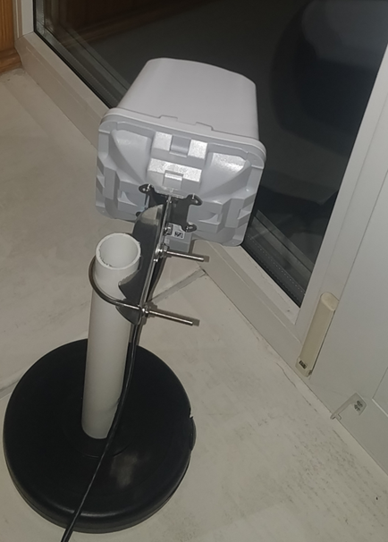

My temporary wireless bridge that will hopefully inspire you:
I use Wireless Wire Cube - 60 GHz with 5 GHz AC backup connection.
As you can see, that’s indoor installation and the distance between the units is about 230 m. There are no obstacles except for window glass of course.
Energy saving glass on one end of the wireless link renders the solution almost inoperable. 60 GHz radio modules cannot connect at all and the throughput of 5 GHz backup link (with 90% uptime) is less than 15 Mbps. If the energy-saving window is open the units establish full speed connection at 60 GHz. So pay attention to the type of glass in your windows.
The “mast” for devices is assembled from 32 mm drainage plastic pipe and 1.5 kg dumbbell weight plate :slight_smile:
What I like about this particular model is the wide operating voltage range: 12-57 V. In my case it is powered by 12V mini-UPS via included PoE injector and 40 m Cat-5 cable.
