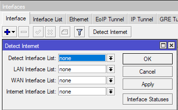

Also check whether Detect Internet is enabled, if yes, turn it off (by setting all lists to none)
Disabling DHCP client on one interface causing unwanted outcomes on another interface might be some side effects of Detect Internet.
