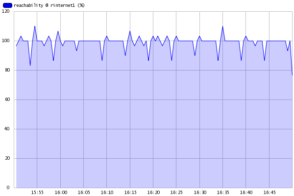

As you may see in the probe thread, i have created a probe to measure reachability.
I have created a function:
Desc: number of replied pings from 10 ping requests (0-10)
Code:
if( array_element(ping(device_property(“FirstAddress”)) , 0)<0 , 0 , 1 ) +
After this I use a probe wich multiplies for 10 and plots the result.
Why do I get more than 100%? I’m adding only TEN logical values, each one should be 0 or 1.
This is what I get. Probably if I manage to fix this little bug I will not only get no peaks over 100% but also less notches/valleys
I’m working with Dude 3.0 Beta 6
Regards,
Pablo
