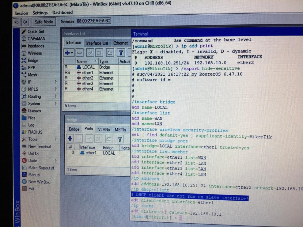

See attachment of results
Notice even though I assigned the IP management address to Ether1, RouterOS assigned it to Ether2. Yikeeeeesssssss.

Here’s what’s happening
Within Oracle VB, I assigned management PC to Adapter1 to MikroTik Ether1 via a Bridged connection
Start MikroTik CHR with base-line factory default configuration
On MikroTik:
Create a bridge (SW-1) and assign Ether1 to this bridge (SW-1)
Assign my management IP to the bridge SW-1 and interface Ether1.
IP, Routes, Add a route to next-hop of inside router, which MikroTik reports as reachable. (here I mistakenly referred to this route a STATIC route but clearly this is not STATIC as RouterOS has a behind the scenes dynamic feature about these statically added entries).
When I assign the gateway IP address within the Quick Set dialog box - (I guess a CLI command is also available) - for the next hop router which happens to be off of Ether2, it changes my configuration of bridge SW-1 to Ether2 (CLI ip address print) and assigns Ether1 as WAN (GUI). Additionally HOWEVER RouterOS does not update the GUI dialog boxes of the SW-1 to Ether2. There seems to be a disconnect between the CLI and GUI at this point.
It appears the software is designed to think it knows better and I guess to overcome user misconfigurations without any warning or notice just changes the configuration and fails to update GUI. Very Interesting.

Ok here is where things go wrong.
Because RouterOS is able to communicate with the upstream router on Ether2 and not on Ether1, RouterOS dynamically modifies the configuration and as I pointed out before, NO NOTICE and NO GUI UP DATES. RouterOS sets the gateway address to Ether2. This change can be seen in the CLI output only- ip address print or also with the export command. The Changes are not updated within the GUI.
ip address print
Flags: X - disable, I - invalid, D - dynamic
ADDRESS NETWORK INTERFACE
0 192.168.10.252 192.168.10.0 ether2
--or--
export
add address=192.168.10.252/24 interface=ether2 network=192.168.10.0
Once Ether2 is able to communicate with the up stream router you cannot change this route unless you create an alternate interface that can communicate with the up stream router. After you add the new interface and the new interface is able to communicate with the up stream router, you can remove Ether2 from your configuration. You can successfully ping this MikroTik CHR bridge from the up stream router. However, the MikroTik cannot ping anything nor can you connect to it.
