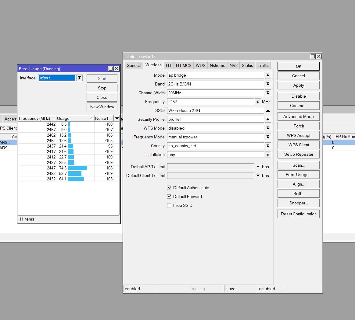

Hi everyone, I’m not an expert but just a geek. I wanted to ask you why my RBWAPG-5HACD2HND AP with 2.4Ghz wi-fi goes at a maximum of 30mpbs while the 5Ghz goes at 180mpbs.
I leave you a screen of the network configuration 2.4

Change frequency to the LEAST occupied one.
I can get close to 100Mb on 2.4GHz IF you make sure nobody else is on the used frequency (which is rarely the case using that band).
And set your country correct.

as you can see from the post I used the least used frequency but by running the speedtest I always get to 30mpbs
Chart is clipped off at 30Mbps, text under it says that max was 42Mbps. So did your speedtest result also came back at 30Mbps? Are you sure there isn’t sone other bottleneck beyond wifi interface? Try testing by using wired connection via the other ethernet port of your wAP.
If it’s correct what you wrote in opening post about 180Mbps over 5GHz, then the most likely explanation is either interference on 2.4GHz band (“least used channel” is not good enough, it has to be pretty empty) or misconfiguration (e.g. allowing to use legacy encryption, such as WPA/TKIP).
Also: you have “manual Tx power” mode set … what is then Tx power setting? Usually this kind of hokus-pokus is not necessary, it’s fine to leave Tx power to automatic.
export configuration and paste it here please.

  1. according to your freq. usage screenshot: channel 2422 is bad. has > 50% usage. 2442/2457 way better.
/interface wireless set [ find default-name=wlan1 ] frequency=2442

Hi, I tried some suggestions you gave me and it actually brought some improvements. Speedtest increased from 29mpbs to 45.

If there is interference, wider channel may decrease throughput.
WiFi is CSMA/CA, it means it will stop transmitting if it detects another transmission at just 3 dB above the noise floor.
If the noise floor is at -100 dBm and you get a signal from your neighbor at -97 dBm, your equipment will stop transmitting.
Even if your neighbor does not actively use WiFi, the AP will broadcast beacons 10 times a second, each of which lasts just a few milliseconds, but it’s enough to wreck havoc on TCP connections.
If there are 10 APs on the same frequency, the amount of beacons transmitted is so large that it becomes almost unusable for everyone.
Please try a UDP speed test. I feel that you’d get at least twice the throughput.
