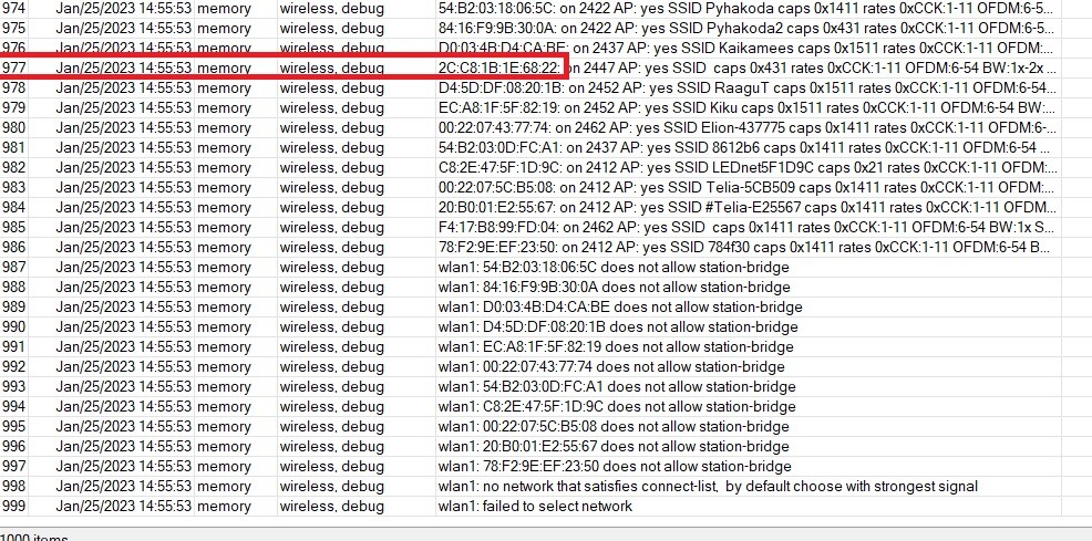

e.g. my LOG … with no match (or nothing) in the connect-list … but here name is in the wifi-station setup. Your LOG may vary.
BSSID/MAC " ::::C4A8" is hidden (not even my AP)

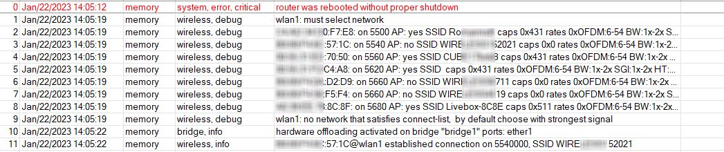

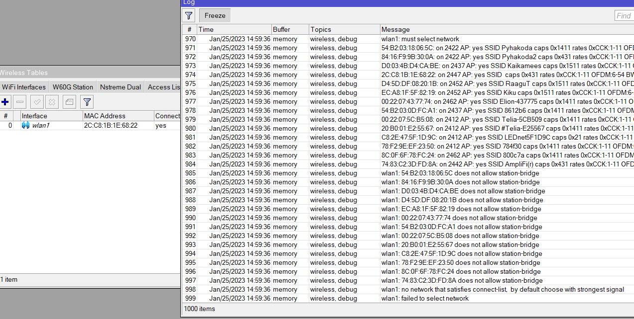

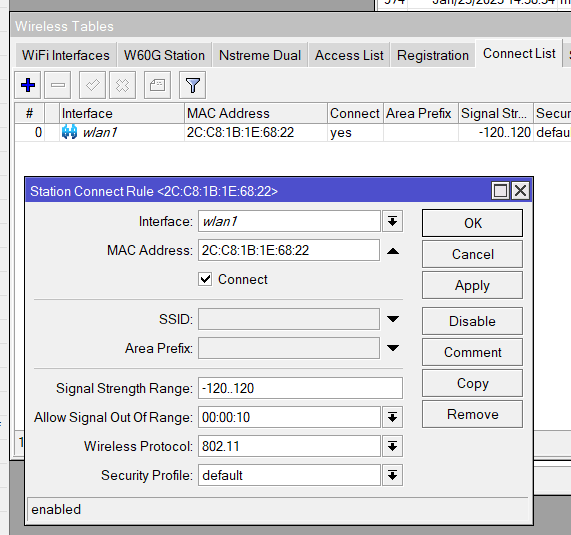

Tested more - cleaned SSID under station WiFi setup.

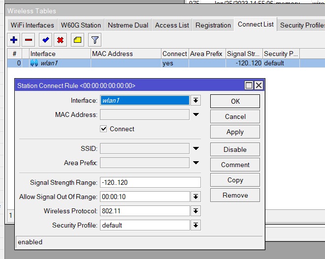

Added interface under connect-list.
First test without name and MAC Address
Log

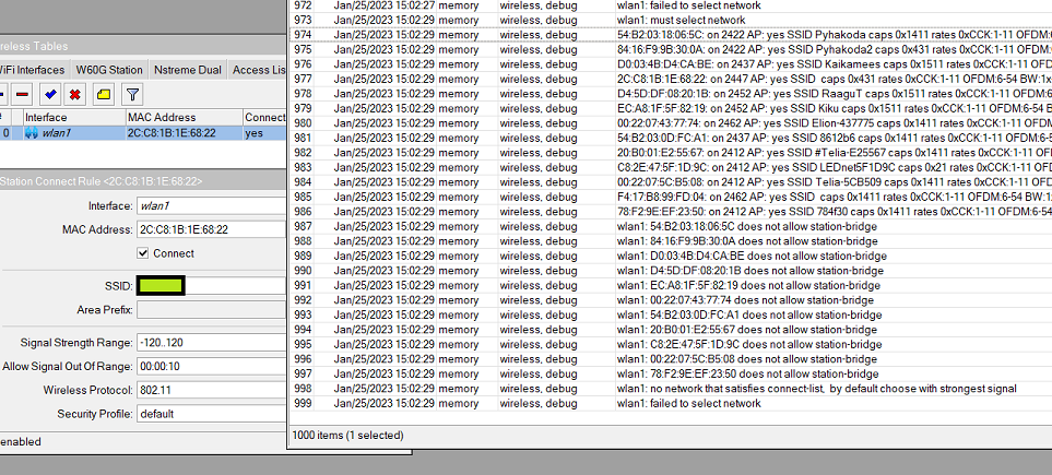

Then with MAC address
Log

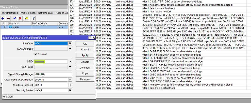

Then with SSID
And then with SSID and MAC
None of them worked. Looks like it just doesn’t check/control them at all.
