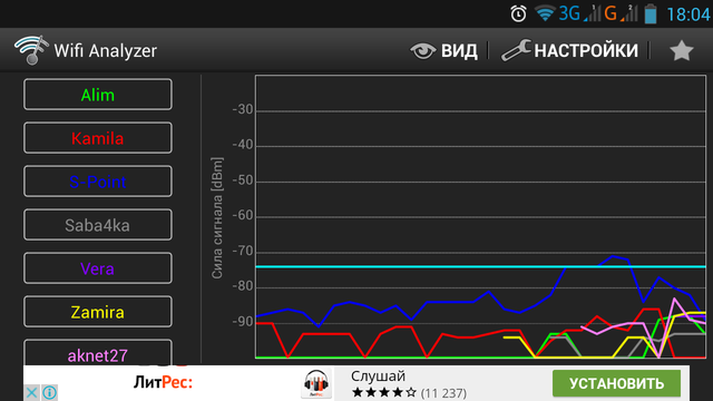

Hello! Set up according to the instructions from the Internet my new toy:HuP Lite RB941 (RouterOS v6.29.1). Found the following: see the picture, I went to my flat, measured the radio signals. Blue - signal Mikrotik, other color signals of my neighbors. I think that the BEACON is sent very rarely.
How can I fix it. My devices are not always connected, there are delays in connecting to 2 minute
Txs

Thanks for the answer. The Internet at this moment available. This problem appears if I put BAND WIRELESS - N ONLY if set B\G\N then the problem disappears.
Leave it as BGN - there may be a wireless device that struggles with N only mode.
