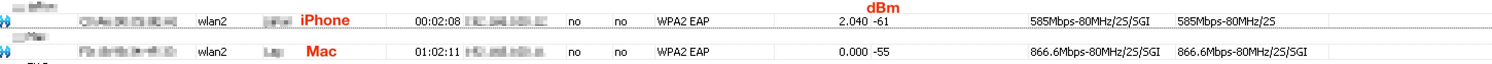

i got little edit for you, interesting thing noticed
https://prnt.sc/3lt8VcBIwErt
my pc working well on this 5g network, also i didnt notice any problem on my 2.4ghz network. Look at uptime.
Are iPhones disconnecting when they are awake or just on standby?
In my case this is only happening when they go to standby (cca 30s after lock), on next awake they reconnect, this is normal behavior to save battery.
I dismissed for info log wireless topic (!wireless) because it bloats log with these messages.
Also it could be that you are on edge of 5ghz signal (laptops usually have larger antennas so they can on same place receive signal better than mobile phones, see image below), 2.4ghz has better coverage because penetrates better through solid objects, but from your logs signal strength looks ok.
