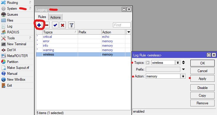

Check the log in the AP.
You must enable the wireless log to see more:
/system logging add topics=wireless action=memory
