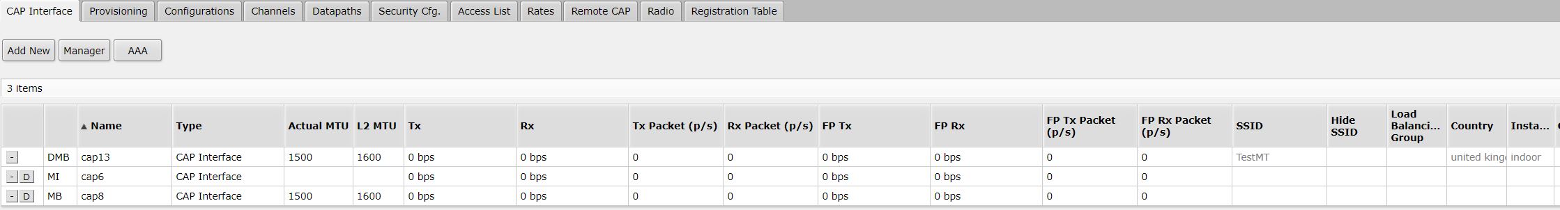

I setup CapsMan as per the you tube video, attached a AP to a (different) PoE switch with the reset pressed port near my desk and waited for the LED to go on solidly. Then I waited a bit more looking at the Wifi Analyser on my phone to see if the new SSID appeared. Needless to say - it doesn't. The AP seems to appear - but thats as far as this whole thing goes
The Cap Interface now looks like: (attached file - Cap-Interface.JPG)
Clearly I am doing something (a lot of things) wrong
