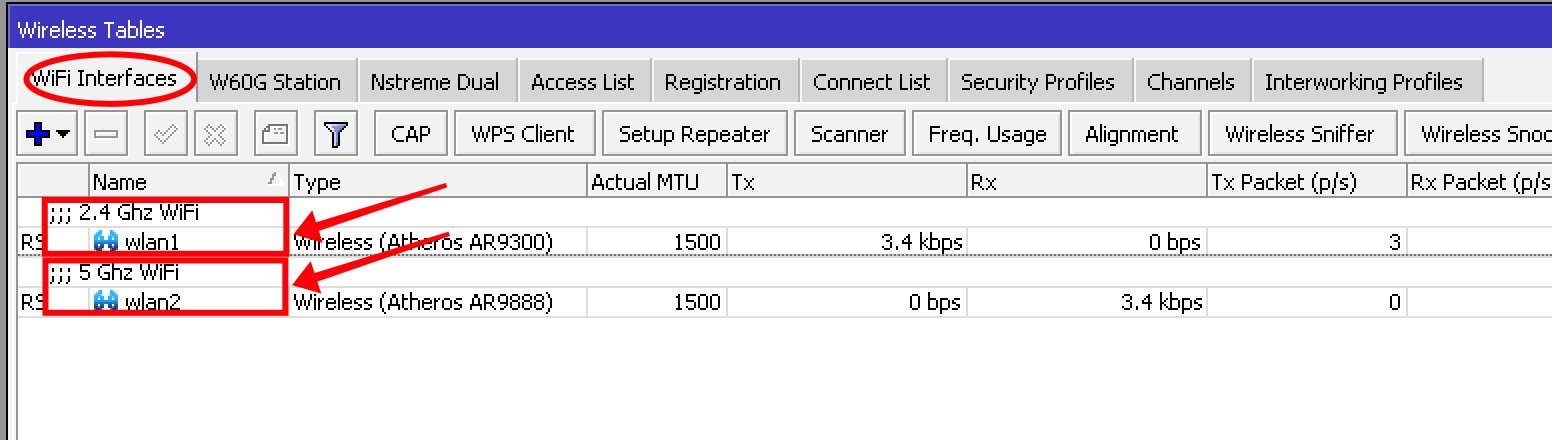

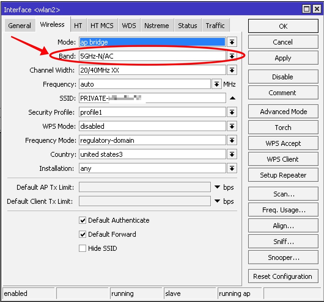

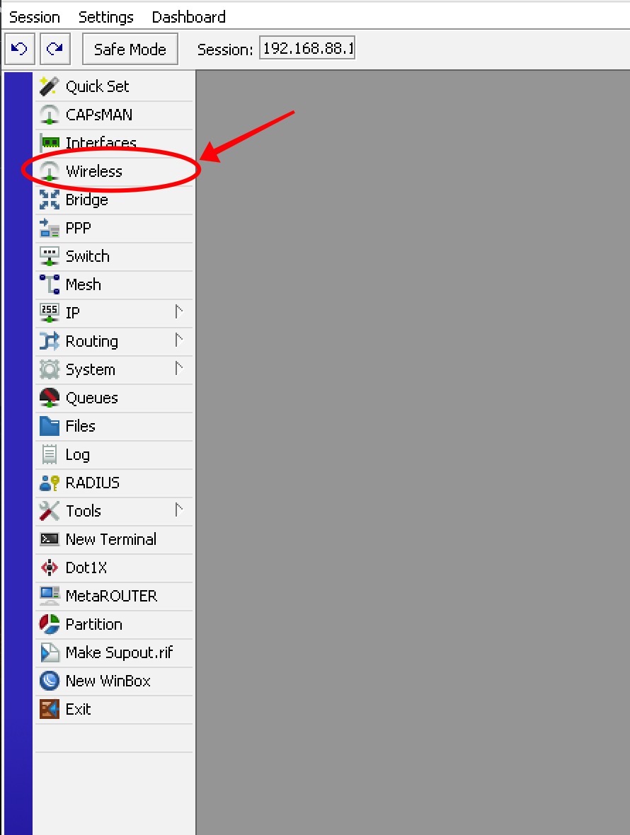

Hi there… how to set it up via Winbox please? Thanks a lot!
Apple devices will always choose 5GHz bands, unless the signal gets unusably bad.
Launch Winbox.
Click “Wireless” in menu…
In the Wireless window that opens, click the “WiFi Interfaces” tab then click on each band (one at a time) to open its Interface screen…
On the “Wireless” tab of the Interface screen, use the pulldown menu to choose the band and protocol…
Regards,
John L.
