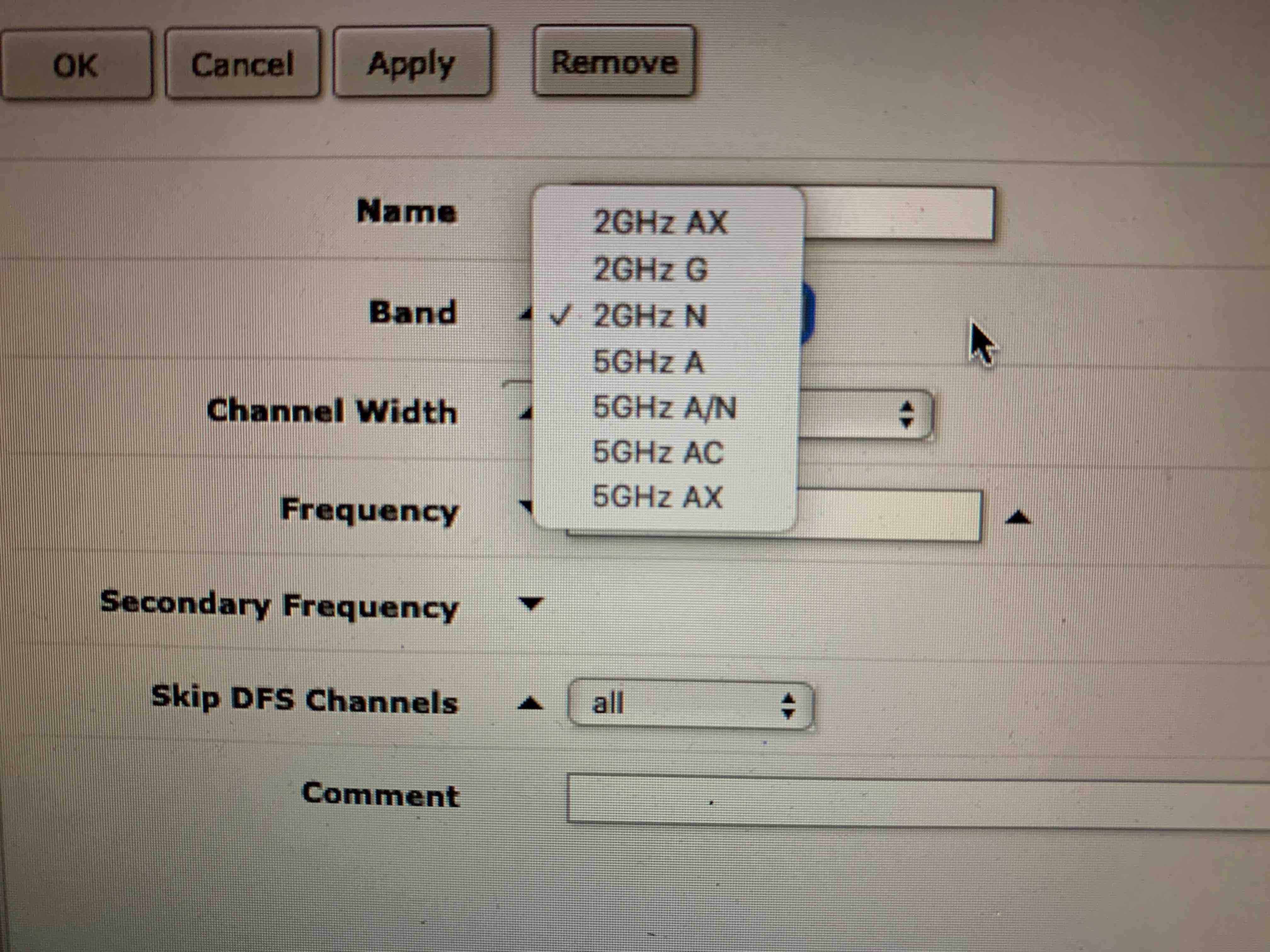

If i configure for instance 2.4GHz Radio, under “Channel” option, or in Interface itself, you need to choose the specific band (2GHz options: AX, G, N ; 5GHz options: A, A/N, AC, AX). But i can select only ONE band ! My actual config is 2.4GHz with N channel, 5GHz with AC channel. But i would like to add also “G” band for 2.4 and “N” band for 5GHz.

How can i define in 2.4GHz radio settings that i would like to use “G” and “N” band simultaneously, if i can select and add only ONE option ? I create a configuration, which i assign to the radio, but in this config is possible define only one band (see picture) and in interface itself is possible to add only one config. So even if i create more configs, i cannot assign more than one to the interface itself. I found this kind of question on more places, also here in forums, but without answer. Or even more easyer question. How would you create setting for 2.4GHz under wifiwave2 to use G and N bands ?
Thank you !
AFAIK it’s “up to …” when selecting one of options. I.e. if you select “2GHz N”, it’ll actually be g/n (I’m not sure about b, might be included as well). Likewise on 5GHz, “5GHz AC” will actually be a/n/ac .

I do believe the answer would be to select G and then you would have AX/N/G support. Would you have selected A, your MT would include A as well.
The reason being: the backwards compatibility costs performance, so you would want to have only AX support to reach the maximum performance and loose the compatibility to legacy standards.

Indeed selecting single wifi standard can mean one of 3 things:
  1. exact value (e.g. selecting 2.4GHz G would mean only G, not N and not B)
  2. backward compatibility (e.g. support anything newer and including selected technology, 2.4GHz G would mean G/N but not B)
  3. “forward” compatibility (e.g. limiting support to not so new technologies, 2.4GHz G would mean B/G but not N)
Mikrotik’s help page doesn’t really say which one is it. However, usual with technology upgrades is that newer devices are backward compatible, which IMO makes option #3 above the most logical (one should not remove support for old technologies, but might disable support for new technologies in case there are some teething problems. Yes, legacy driver does allow one to set things according to #2 and #3 at the same time, wifiwave2 does not).

Im familiar that we are talking about WiFi Standards, i just would like to mention exactly the “option” directly from RouterOS where “BAND” stands for standard (as you see in the picture above). I would like to avoid confusing and i did exactly the opposite, im sorry for that. As mentioned, there is also lack of information in Mikrotik-s documentation, therefore is now confusion also on my side. It is now funny situtation since to clarify exactly how it is working, i need to grab some older device and give i try which of “3 working methods” is applied for this part, if device with only “G” standard antenna will work.
Some experiment with the wifi standards (Mikrotik: “Band”):
  • Using the setting “n” => Even my latest devices connect only with 802.11n
  • Using the setting “ax” => Latest devices connect with 802.11ax, older devices connect with lower standards (e.g. iMac from 2017 which supports a/g/n/ac)
As far as I know that has to be the case since Wi-Fi 6 is designed to be backwards compatible with previous standards.
Actually the topic was opened by me, but nearly 2years ago when wifiwave2 appeared. Anyways, thank you for your response ! Hopefully this informations will help others also to understand, that the standards are the “max set” and backward compatible.
