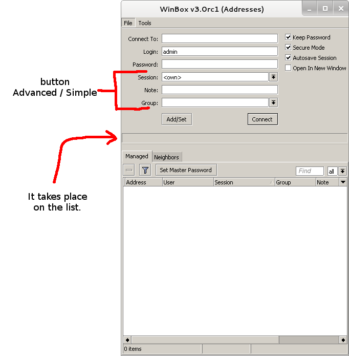

  1. Can1t save session with invalid characters for file name, like “:” containing in MAC. Only temp file will be created in winbox.exe containing folder, something like this: viwBEBC.tmp. Maybe RB SN will be better as default name.
  2. Winbox 3rc1 crashed many times, without any errors and supout files. Debug log will be very useful!
  3. When master password is enabled - last session address, password can be used after restarting app!
  4. Steps of reproduction:
    ! open in new window opt. - enabled
    ! master password - created
    ! don`t enter master password after app start
  • some manipulations with app, like connecting to RB
  • enter master password and press ENTER on keyboard
    Last focused button in app will be pressed instead of OK button.
  1. Session list refreshing only on winbox start-up.
