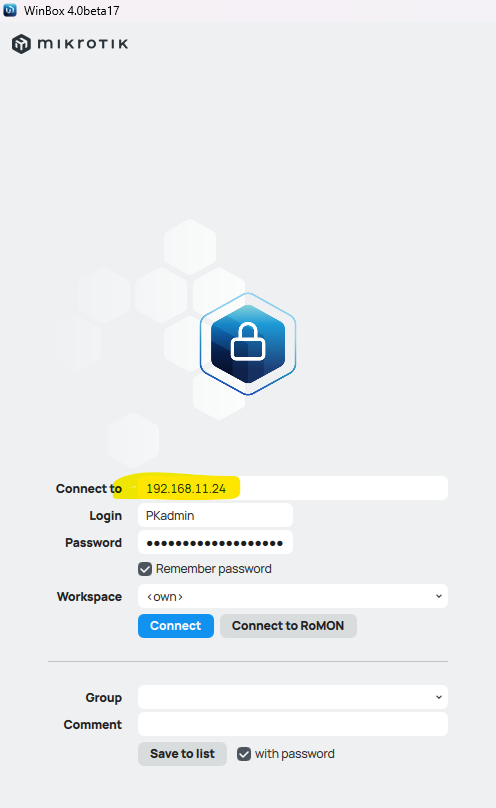

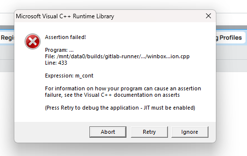

I'm busy setting up a Point to Multipoint network and I keep on getting the following error after setting up a Cube 60Pro in station-bridge mode when I use the IP to connect. If I use the MAC Address then I can connect.

There is one mention of assertion (which I thought was related to testing), don’t know if it is related.
