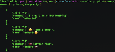

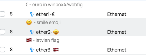

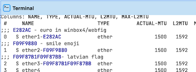

Ah, but the WinBox4 Terminal is like weird transfer area at an airport :wink: Take some UTF-8 stuff in an interface name/comment:
If one follows the UTF-8 is the ā€œcodepageā€ for WinBox4, its terminal should also render UTF-8. What I’ve found is the WinBox4 Terminal uses the hexstring for high-ASCII, same as other terminal/ssh/etc:
So - feature request re UNICODE - the WinBox4 Terminal should render UTF-8, not the hexstrings. It seems RouterOS can know it’s a WinBox4 terminal & avoid the ā€œhexstring substitutionā€ā€¦ But currently even if raw UTF-8 get’s in to the Terminal, it does even show that - while SSH does:
Perhaps this is solvable by some ā€œ/console/settings/set outputUtf8=yesā€ … but it would be nice to see UTF-8 so if one did use that in WinBox4, the UTF-8 render in at least that terminal.

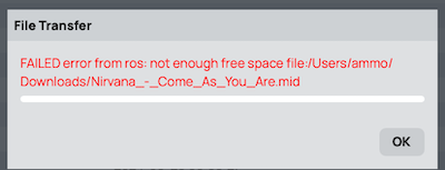

BUG? — drop-drop file(s) fails with error message about disk space
(MacOS 15.0 / WinBox4 beta8)
My test router has a raid1/ volume with 50GBs free, but the root does have limited space. Upload the WinBox4 button, works fine. But when I drag a file from finder to a disk or directory under raid1/…, I get an error message:
IDK the issue, but maybe it’s trying to write it to the SAME path? Using that path…would not work since only a starting path of raid1/ would have enough room. BUT… I did drop it only a specific directory/disk/area - and that’s what directory should be used ā€œon dropā€. Tried a few different places and other files, but all failed similarly.
Not sure if this is a 7.16 or Winbox 4 Beta 8 issue, since I just got this device today and immediately updated it to 7.16.

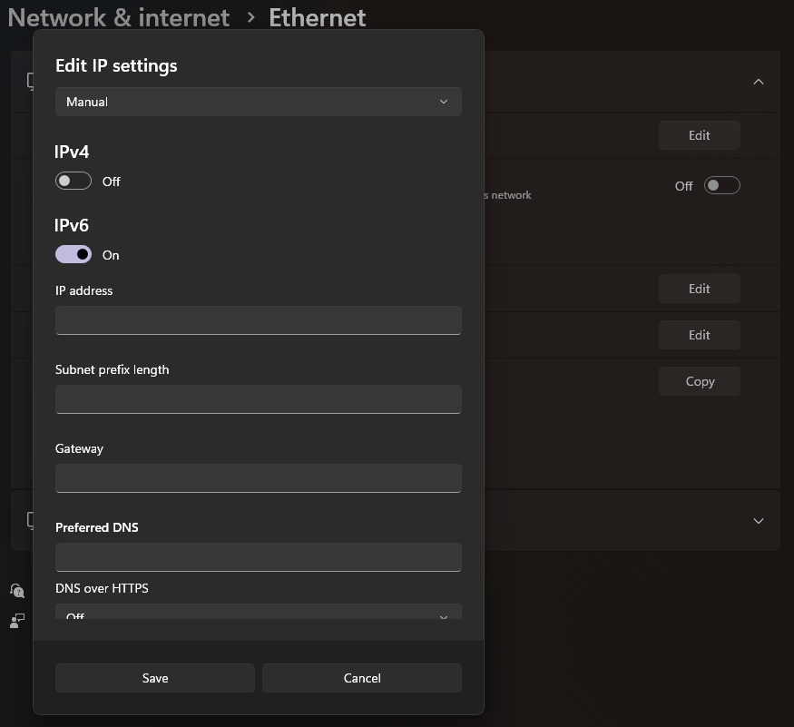

Let’s look at this brand new interface in Windows 11 to edit the IP settings. Should be similar to when we edit an IP → Address entry in WinBox, right?
What shortcut do I use if I don’t like the changes and want to close this. Hint it’s not Ctrl+W
