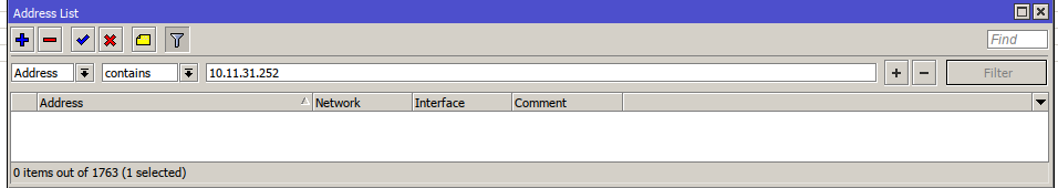

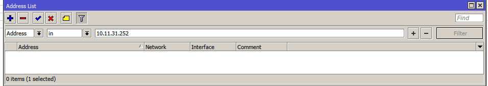

Is my syntax off , or am i missing something when i try to filter an address , via the Winbox Filter, in /ip fire address-lists
(see attached screen shot)
reguardless of what i try to put here, i always end up with 0 results. (name filtering works fine however)

In columns that have an IP address there is a filter “in” and “not in” that you should use for those purposes.
E.g. “Address in 192.168.0.0/16”

As far as I can see, when selecting Address filter under Address List in WinBox, the drop-down contains does not work.
If I like to find all IP that contains 192, contains should be the word to select.
It should then find both:
192.168.88.1
10.192.44.32
in, only select ranges, like 192.168.88.0/24 and works well.

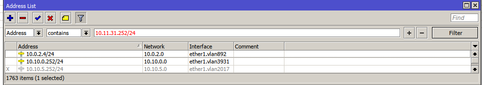

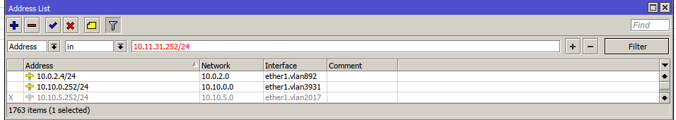

This issue still persist, every time i need to filter IP address i faced this bug. Even if you try to filter with mask this does nothing.
Your input is wrong. When you use “in” you should use a valid subnet, so 10.11.31.0/24 not 10.11.31.252/24.
Winbox shows it is wrong by coloring it red.
Yes, you are using “in” wrong.
But there is a bug with “contains”. We will fix that
