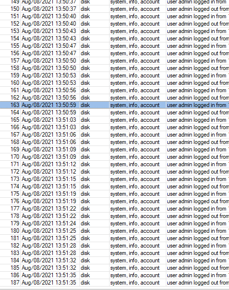

Could you please help with this issue:
I’m logged in to router through winbox and a lot of these messages appear why?
Since you did not post the end part of the message, we do not now it it comes from internett or your inside.
It may show one or multiple IP.
You should never logg directly inn to the router from internett without using VPN. (or steps to secure it)
Yur device is monitored from The Dude.
Yes, this is right and I also connected to the router from the internet directly. Connection are limited for specials IP addresses. I will try to figure out why he send so many request to log in
This is standard behavior after 6.4?.? version (i do not remember exactly what).
For each ros_command on The Dude, is open and closed a connection, for retrieve the value, for each interval defined on the probe timer.
So you connect to the router via winbox from the intrernet WITHOUT VPN or port knocking???
