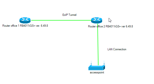

I have a problem with devices on my network. The problem is that although I can see all devices in winbox, after logging into router 2 (second office) winbox shows me an empty configuration and after about 10 seconds it drops the connection. After a while it connects again and the problem looks exactly the same. After connecting to router 1 winbox works without any problems. Has anyone had a similar problem? If so, I would very much appreciate your help. Connection drawing in the attachment.
Where is the PC that you are using connected to? By that I mean are you connected to a LAN on Router 1, Router 2, something else?
If you physically plug into the router that you can’t access (rather than accessing across the tunnel), does it work?
What version of WinBox are you using?
Are you trying to access via a MAC or IP address?

Suggestion: check the connection and connection speed with router2 (EoIP tunnel ?)
Thanks. In the mean time I have solved it with lowering the MTU.
