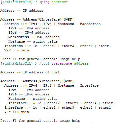

On "Traceroute To" you can specify not only the IP, but also:
VRF
192.168.0.1@main
Interface
192.168.0.1%ether1
Both
192.168.0.1%ether1@main
You can only specify VRF with @vrf appended to the end of the address. Routing tables without VRF are no longer supported.
