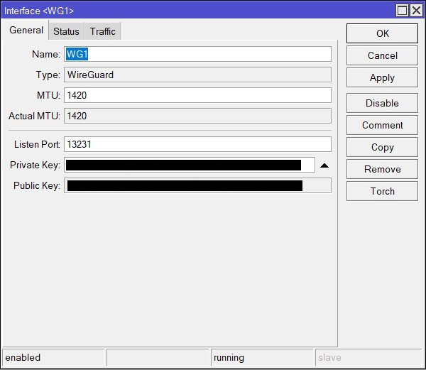

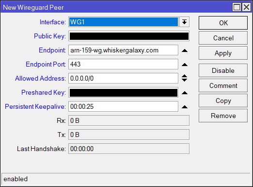

Reading other similar topics, I have set up the following so far via Winbox: WireGuard Interface, Peer
Any help with the rest of the settings?

The wg settings on your device appear to be okay.
Looking at the providers output,
Okay so they have provided the endpoint address for you to put into the MT peer settings.
arn-159-wg.whiskergalaxy.com and port 443.
Not sure what to do with this 100.113.246.2/32 though???
You used the public key they generated to put into the MT peer settings…
You gave them your public key the MT generated for them to use.
Not sure why we care about the DNS they provided ???
Also pre-shared key that is not something ive seen used yet, is it just blanked out because there is no entry??
