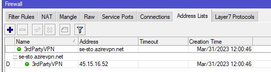

GO TO FIREWALL ADDRESS LIST and create one call it 3rdPartyVPN, so that you can see the resolve at any time
The address may change so using a fixed IP is not the best solution.
aka DO NOT USE the number!! The config you posted seems fine as it uses the address…

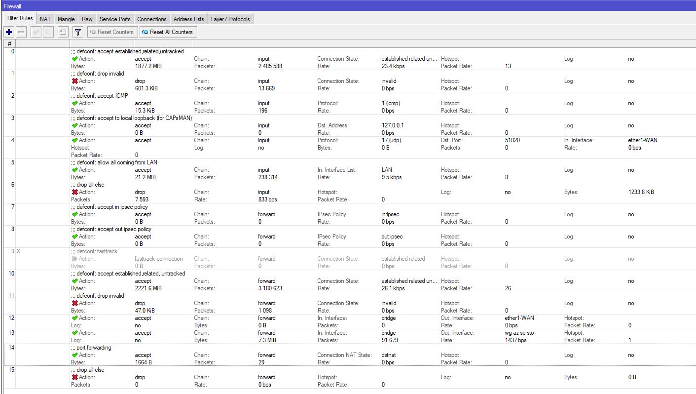

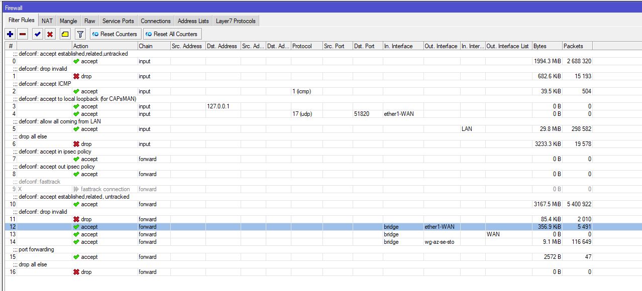

(5) FIXED FIREWALL RULES. Note, ORDER is important within a chain!!!
INPUT CHAIN
( got rid of output rule, not required , you had handshake input rule disabled??, block dns rules were redundant and removed, → allow all traffic from LAN then drop all else!! )
( your input rules for SSH and winbox were dangerous and removed, and also not required as LAN access is already available.)
FORWARD CHAIN
( added bridge to wan access, a proper separated allow port forwarding rule and then drop all else rule)
    established,related,untracked
    invalid
add action=accept chain=input disabled=no dst-port=51820 in-interface=\
    ether1-WAN protocol=udp
add action=accept chain=input comment="defconf: allow all coming from LAN" \
   in-interface-list=LAN
add action=drop chain=input comment="drop all else"
    ipsec-policy=in,ipsec
    ipsec-policy=out,ipsec
    connection-state=established,related disabled=yes hw-offload=yes
    connection-state=invalid
add action=accept chain=forward in-interface=bridge out-interface=\
    WAN
    wg-az-se-sto
add action=accept chain=forward comment="port forwarding" connection-nat-state=dstnat
add action=drop  chain=forward comment="drop all else"

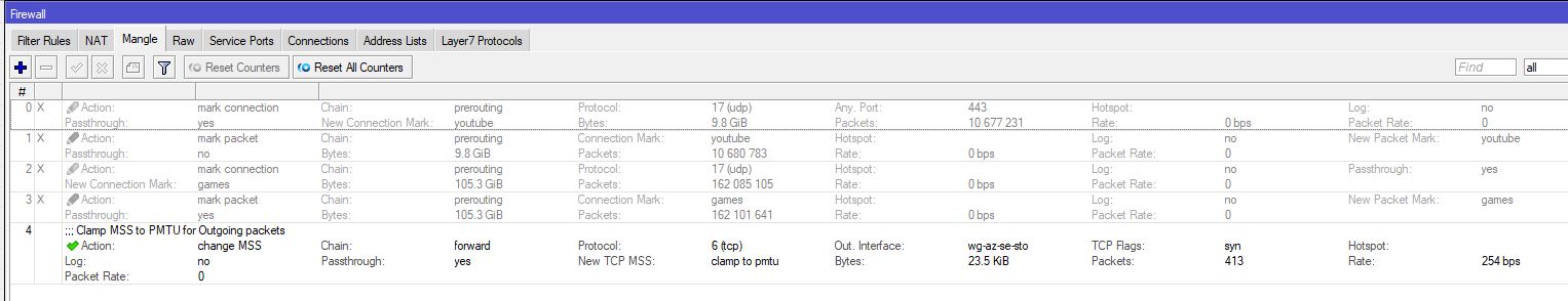

(6) NO MANGLING REQUIRED, remove all mangling rules concerning the connection, it seems like they are for other bogus reasons.
In order to troubleshoot your wireguard, disable mangling rules for now !!

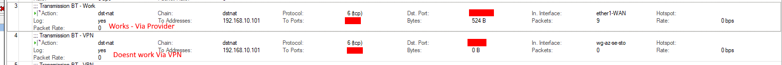

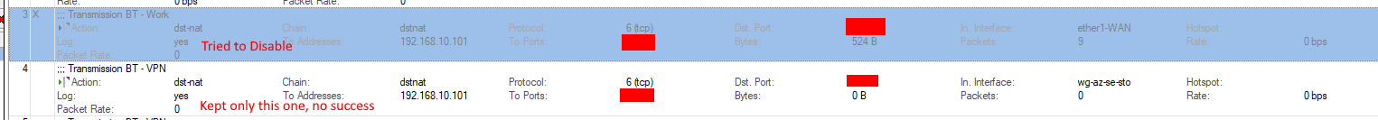

(8) WHAT are these port forwarding rules for ???
add action=dst-nat chain=dstnat comment=Lox dst-port=6789 in-interface=
ether1-WAN log=yes log-prefix=Lox protocol=tcp to-addresses=
192.168.10.100 to-ports=6789
add action=dst-nat chain=dstnat comment=“Transmission BT” dst-port=
6665 in-interface=ether1-WAN log=yes protocol=tcp to-addresses=
192.168.10.101 to-ports=9911
Remember, if you have incoming traffic on the WAN, you are FORCING TRAFFIC into the TUNNEL.
Thus how do you expect the return traffic from bridge devices will then go back out WAN ??? See 12.

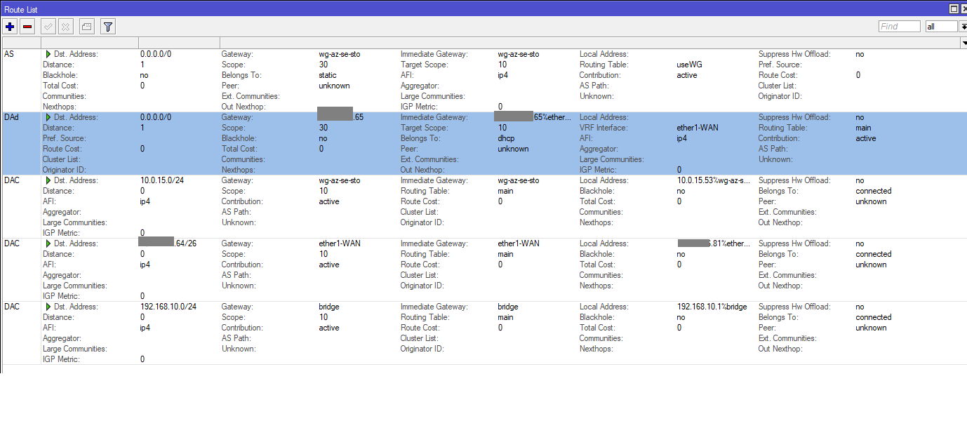

(9) WHERE IS WAN IP route. It will not be visible if you have selected default route in IP DHCP Client. So will assume you have, otherwise you need a manual IP route.
AND GET RID OF BOGUS ROUTE.
add dst-address=45.15.16.52 gateway=10.38.166.65
add dst-address=0.0.0.0/0 gwy=ISP_gwy_IP routing-table=main { ex of manual route, probably not necessary if route already exists }
add dst-address=0.0.0.0/0 gwy=wg-az-se-sto routing-table=useWG

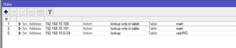

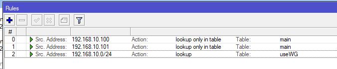

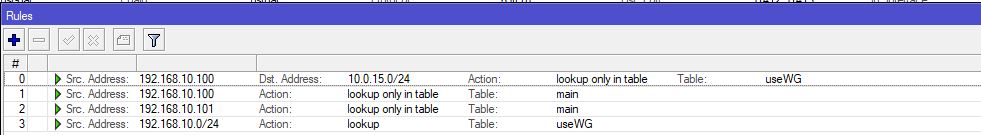

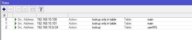

(12)
Need two additional routing rules for your port fowarding to work… ORDER is key.
/routing rule
add action=lookup-only-in-table src-address=192.168.10.100 table=main
add action=lookup-only-in-table src-address=192.168.10.101 table=main
add action=lookup src-address=192.168.10.0/24 table=useWG

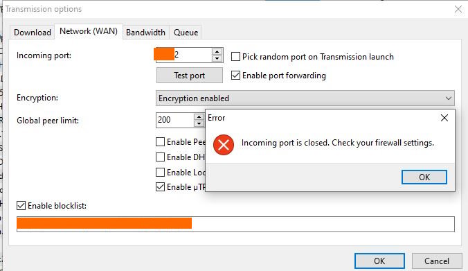

Thanks for helping out, i tried to put all modifications as you suggested.
duckduckgo.com, mail.proton.me still not loading
PortFWD doesnt work now
All devices are on VPN Sweden location and most of pages working so far except few

  3. used se-sto.azirevpn.net and seems like it’s resolving it’s IP , does it somehow read / add into the WG settings? As provider is using only “se-sto.azirevpn.net
    This way i’ll add later other Locations

  6. Mangling disabled - i guess i added them follow some guide to identify type of traffic

  8. Those are local servers which i want to access from Internet, those rules were working fine.
    Plan is to add few more with WG and it’s WG Public IP , add few servers to be reachable via duckdns.org address
    So some stay on Provider Public IP and some will be on WG VPN Public IP
  9. Done

[admin@MikroTik_Ax3] /ip/route> add dst-address=0.0.0.0/0 gateway=wg-az-se-sto routing-table=useWG

Your config
“defconf: accept established,related,untracked” connection-state=
add action=drop chain=input comment=“defconf: drop invalid” connection-state=
invalid
add action=accept chain=input comment=“defconf: accept ICMP” protocol=icmp
“defconf: accept to local loopback (for CAPsMAN)” dst-address=127.0.0.1
add action=accept chain=input dst-port=51820 in-interface=ether1-WAN
protocol=udp
add action=accept chain=input comment=“defconf: allow all coming from LAN”
add action=drop chain=input comment=“drop all else”
add action=accept chain=forward comment=“defconf: accept in ipsec policy”
add action=accept chain=forward comment=“defconf: accept out ipsec policy”
add action=fasttrack-connection chain=forward comment=“defconf: fasttrack”
“defconf: accept established,related, untracked” connection-state=
add action=drop chain=forward comment=“defconf: drop invalid”
wg-az-se-sto
add action=accept chain=forward comment=“port forwarding”
add action=drop chain=forward comment=“drop all else”
My CONFIG recommendation:
invalid
WAN
wg-az-se-sto
add action=accept chain=forward comment=“port forwarding” connection-nat-state=dstnat
(3) I dont get it, you clearly are not reading or thinking. I stated that ORDER is critical in routing rules.
I stated that for the return traffic from servers to reach back to the WAN they would need to be PRIOR to the rule forceing ALL bridge traffic out the WAN so what did you do???
/routing rule
add action=lookup disabled=no src-address=192.168.10.0/24 table=useWG
add action=lookup-only-in-table src-address=192.168.10.100 table=main { WRONG this will never be used all traffic goes out wg }
add action=lookup-only-in-table src-address=192.168.10.101 table=main { WRONG this rule will never be used all traffic goes out wg }
What I had provided:
/routing rule
add action=lookup-only-in-table src-address=192.168.10.100 table=main { server traffic gets out local WAN as required }
add action=lookup-only-in-table src-address=192.168.10.101 table=main { server traffic gets out local WAN as required }
add action=lookup src-address=192.168.10.0/24 table=useWG { rest of bridge traffic goes out wg }

  1. removed completely
  2. Seems like this was mistake i had to modify:
    FROM:
    add action=accept chain=forward in-interface=bridge out-interface=WAN
    TO:
    add action=accept chain=forward in-interface=bridge out-interface=ether1-WAN
Hopefully now correct all
3. I entered those commands , but seem like the order is not right. How to change order? As in FW rules i’m able to change order in WinBox - mouse drag & drop
Or i need to remove them a re-add in specific order?
Removed & re-added
[admin@MikroTik_Ax3] > /routing rule
[admin@MikroTik_Ax3] /routing/rule> add action=lookup-only-in-table src-address=192.168.10.100 table=m
ain
[admin@MikroTik_Ax3] /routing/rule> add action=lookup-only-in-table src-address=192.168.10.101 table=m
ain
[admin@MikroTik_Ax3] /routing/rule> add action=lookup src-address=192.168.10.0/24 table=useWG
YOu are quite correct, the config I was supposed to type is
add chain=forward action=accept in-interface=bridge out-interface**-list**=WAN
( your fix is equally as valid !! )
The yolk is on my face for that one!! :slight_smile:
Yes the second attempt worked, the clue is looking at the rule numbers at the left hand column 0,1,2 etc…
OKAY, so you are saying its about 98% there ?? Some webpage shenanigans…
If so try
a. changing MTU to 1500 if no joy
b. return to default 1420 and try this and then with MTU at 1500
/ip firewall mangle
add action=change-mss chain=forward comment=“Clamp MSS to PMTU for Outgoing packets” new-mss=clamp-to-pmtu out-interface=wg-az-se-sto passthrough=yes protocol=tcp tcp-flags=syn
c. if no joy set MTU to 1420 and try this one.
/ip firewall mangle
add action=change-mss chain=forward new-mss=1380 out-interface=wg-az-se-sto protocol=tcp tcp-flags=syn tcp-mss=1381-65535
  1. Rule 12 can be removed now? as it was wrong and should be rule 13 ?
  2. With adding the command , started to work, changing to MTU 1500 didnt worked out.
    /ip firewall mangle
    add action=change-mss chain=forward comment="Clamp MSS to PMTU for Outgoing packets" new-mss=clamp-to-pmtu out-interface=wg-az-se-sto passthrough=yes protocol=tcp tcp-flags=syn
Rest of pages are working now :astonished:

I tried to add ports for Transmission and it says is not open
What i’ve analyzed so far - ports from my “regular” IP via “ether1-WAN” are reachable via FW rules, so i assume the rule is right.
All ports via VPN “wg-az-se-sto” interface , seems NOT reachable
Thanks!

Just for giggles try this to see if it works.
/routing rules. ( in correct order of course )
[1st] add action=lookup-only-in-table dst-address=10.0.15.0/24 src-address=192.168.10.100 table=useWG { allow return traffic to wg server clients } *****
[2nd] add action=lookup-only-in-table src-address=192.168.10.100 table=main { allow return traffic out through local wan }
[3rd] add action=lookup-only-in-table src-address=192.168.10.101 table=main { allow return traffic out through local wan }
[4th] add action=lookup src-address=192.168.10.0/24 table=useWG { last rule to force rest of bridge out wg tunnel }
***** assumes you are sourcnatting the traffic from the WG server to your router. In other words your internal server doesnt see other public IPs but sees a wireguard source address for this rule to work.
Tried, but still not PortFWD via VPN
Removed former rules
Added suggested:
Tried those options:
Even tried to disable working rules, if they dont interfere each other
Why are you trying to port forward the wg traffic coming in on the MT?
The traffic coming in on WG is already on the LAN so to speak…
The port forwarding or moving the traffic appropriately into the WG tunnel and towards the MT is done at the azure site.
The only rule really needed at the MT end is a firewall rule.
add action=forward chain=forward in-interface=wireguard dst-address-list=serverlist
