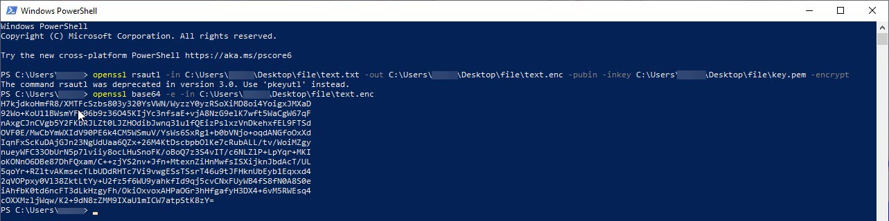

@own3r1138, would you mind a private talk on this? I have some doubts, but I don’t want to discuss them here on the forum as I’m sure the guys who are responsible for this whole topic monitor the forum too. If so, http://forum.mikrotik.com/t/bobcat-miner-300-relayed/154400/1 .
I hope I did it right.
H7kjdkoHmfR8/XMTFcSzbs803y320YsVWN/WyzzY0yzRSoXiMD8oi4YoigxJMXaD
92Wo+KoU11BWsmYFg06b9z36O45KIjYc3nfsaE+vjA8NzG9elK7wft5WaCgW67qF
nAxgCJnCVgb5Y2FKbRJLZt0LJZHOdibJwnq31u1fQEizPslxzVnDkehxfEL9FTSd
OVF0E/MwCbYmWXIdV90PE6k4CM5WSmuV/YsWs6SxRg1+b0bVNjo+oqdANGfoOxXd
IqnFxScKuDAjGJn23NgUdUaa6QZx+26M4KtDscbpbOlKe7cRubALL/tv/WoiMZgy
nueyWFC33ObUrN5p7lviiy8ocLHuSnoFK/oBoQ7z3S4vIT/c6NLZlP+LpYqr+MKI
oKONnO6DBe87DhFQxam/C++zjYS2nv+Jfn+MtexnZiHnMwfsISXijknJbdAcT/UL
5qoYr+RZltvAKmsecTLbUDdRHTc7Vi9vwgESsTSsrT46u9tJFHknUbEyb1Eqxxd4
2qVOPpxy0Vl38ZktLtYy+U2fz5f6WU9yahkfId9qj5cvCNxFUyWB4fS8fN0A8S0e
iAhfbK0td6ncFT3dLkHzgyFh/OkiOxvoxAHPaOGr3hHfgafyH3DX4+6vM5RWEsq4
cOXXMzljWqw/K2+9dN8zZMM9IXaU1mICW7atpStK8zY=
