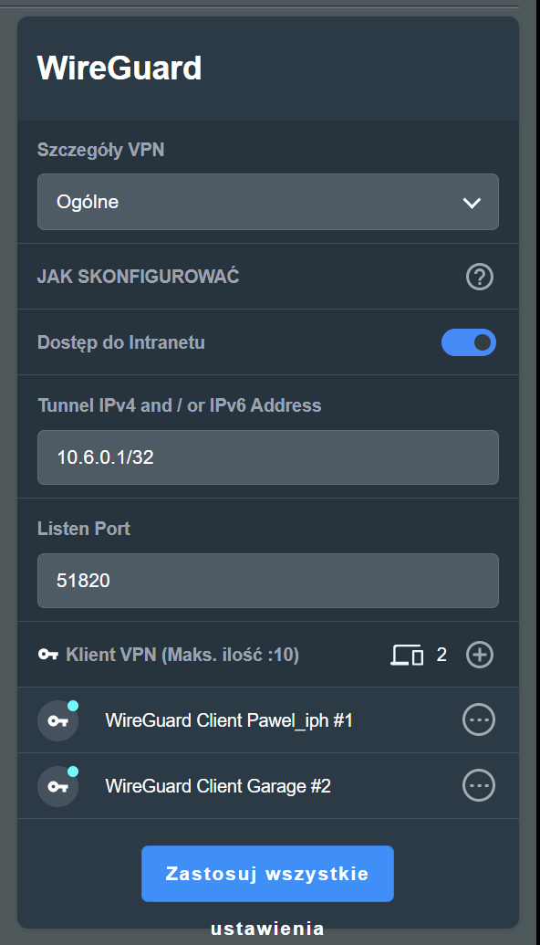

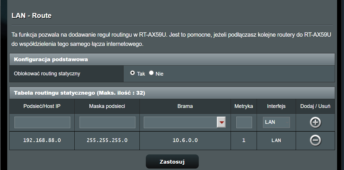

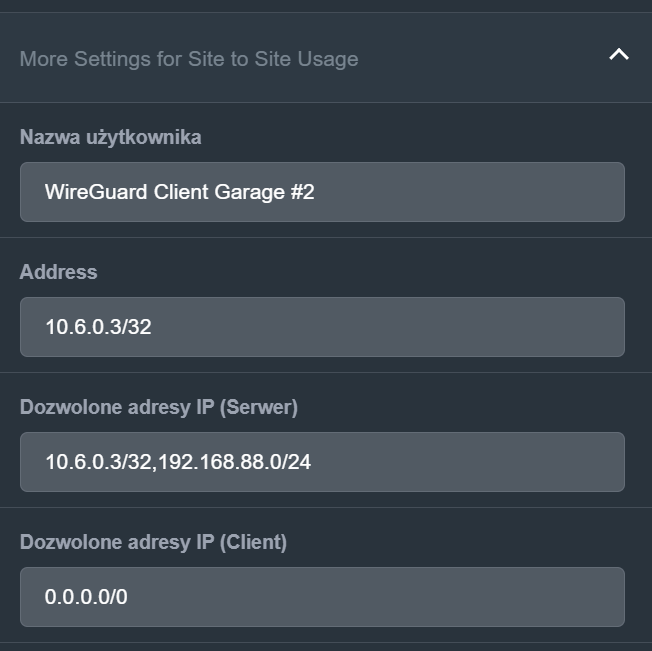

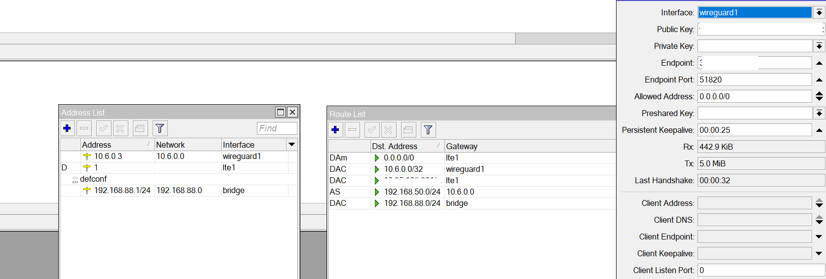

- Main/home router (vpn server) - Asus
- Router with LTE in another place - hAP ax lite LTE6
- Mobile device connected to home network through VPN
I expect it will be possible to have a connection between any device connected to the network, for example: phone can see device connected to Mikrotik - all through the connection to the vpn server.
So far I managed connection between Asus and MT - I can ping device connected to MT from laptop in home network and vice versa.

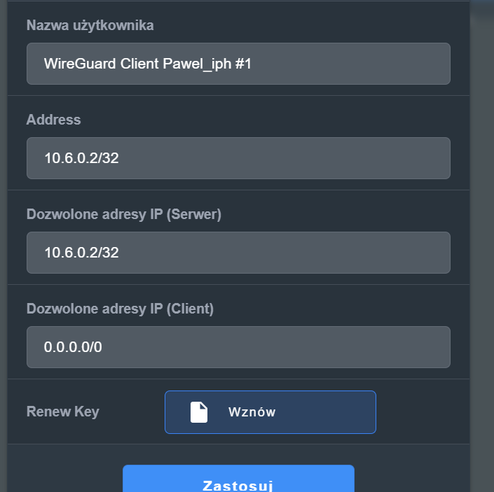

But in next step I have problem - I have configured VPN for my phone and after connecting to the server I see the router and also the devices connected to it but only in home network.
I can’t see Mikrotik and its devices.
Is this a problem with mikrotik configuration or server? For example these are screens of my config
