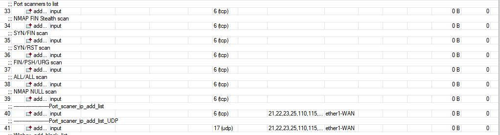

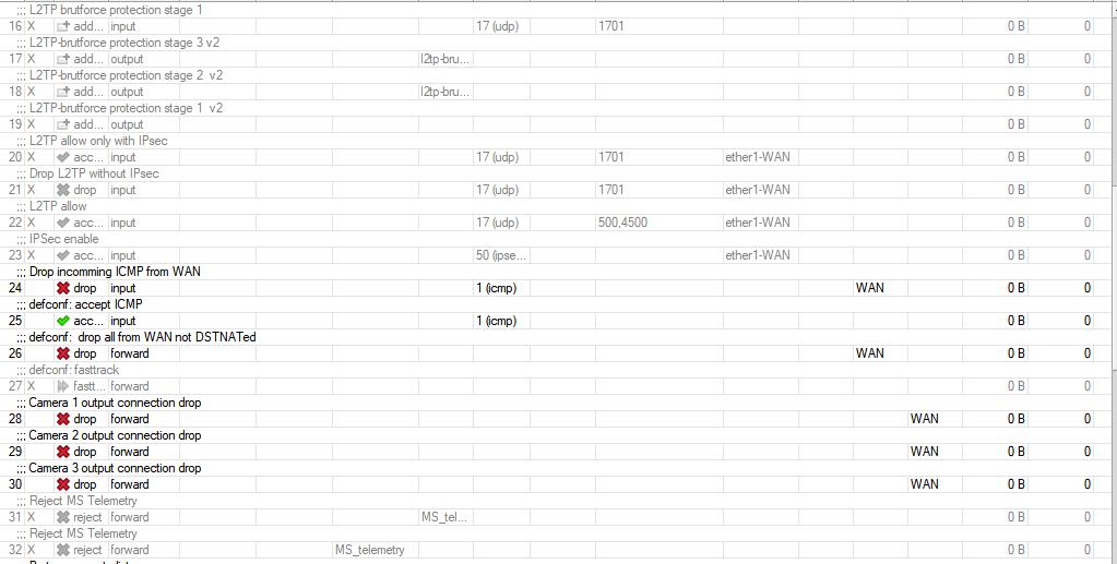

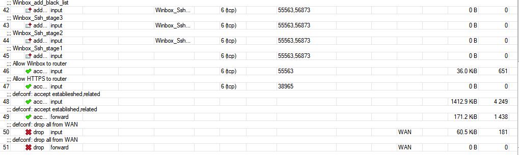

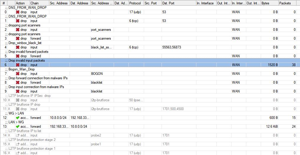

And from my perspective it looks not so terrible in Winbox (see attached screenshots)
not even sure what L2TP brute force protection is about?
  • Couple month ago there was an L2TP/IPsec server on that MT. And that list of rules/scripts was created for L2TP protection because of the amount of brutforce attempts.
